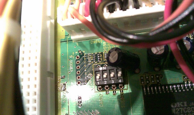

    Maybe some good news here..
    I disconnected the HDD and the unit refused to boot from the DVD-drive. I tested this with a CD containing IMSA and a DVD containing the cadillac demo.
    Next, i set DIP switch #4 to the off position.
    Now the unit boots the IMSA CD without HDD installed, but still refuses to boot the cadillac DVD. That one probably really needs the HDD for data installation/reading.

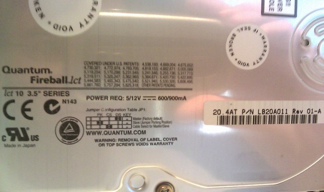

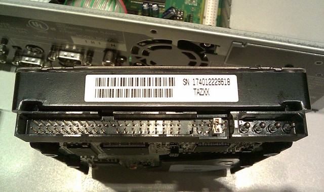

    Here some images of the HDD:
    Windows indeed reports the HDD as FAT formatted, no label and seems to be able to determine the percentage used/free etc. The root contains one subdirectory called "ModelYea.r.2" but is unable to open it, or to report details about it. Also there is one 0-byte file in the root, called Cadillac.

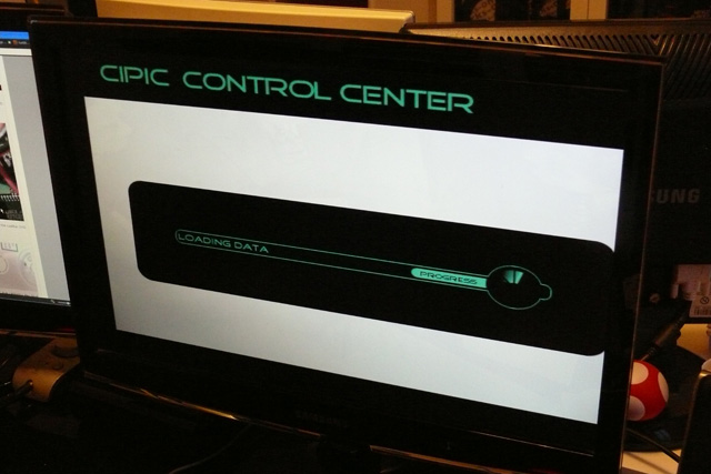

    One access after 45 secondes and a screen with :
    CIPIC CONTROL CENTER
    Hard drive not detected
    Configuration error

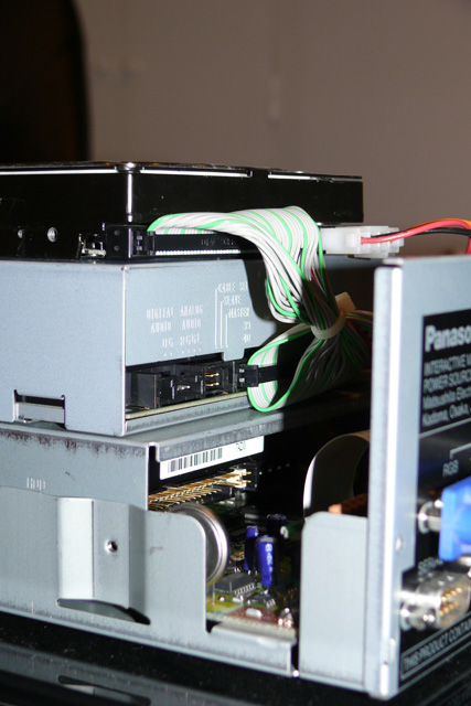

    Suddenly, I had doubts. So I opened the box and there is a hard drive under the DVD drive. I don't understand. :-\

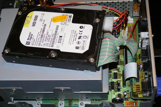

    I tried differents things.
    Disconnect the hard drive : Black screen, no activity.
    Set DIP switch #4 to the off position : Black screen, no activity.
    Connect an old WD1600 drive : After a long, long, long installation, the Cadillac disc works.
