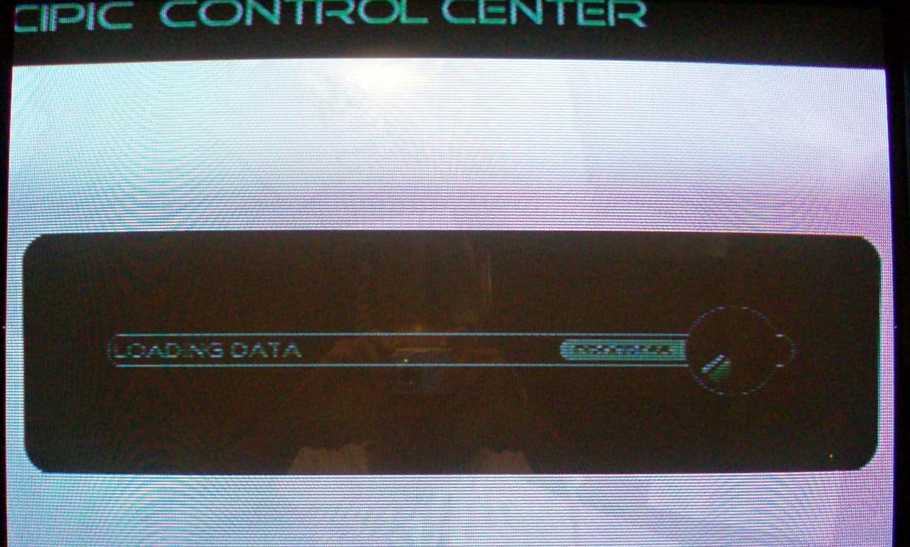

    Right now I'm at the 'Loading Data screen'.

    The progress green icon spun around a little bit and then stopped. While it was spinning, it sounded like the HDD was initialized or was written to.
    Now the HDD is quiet and DVD access light is flashing.

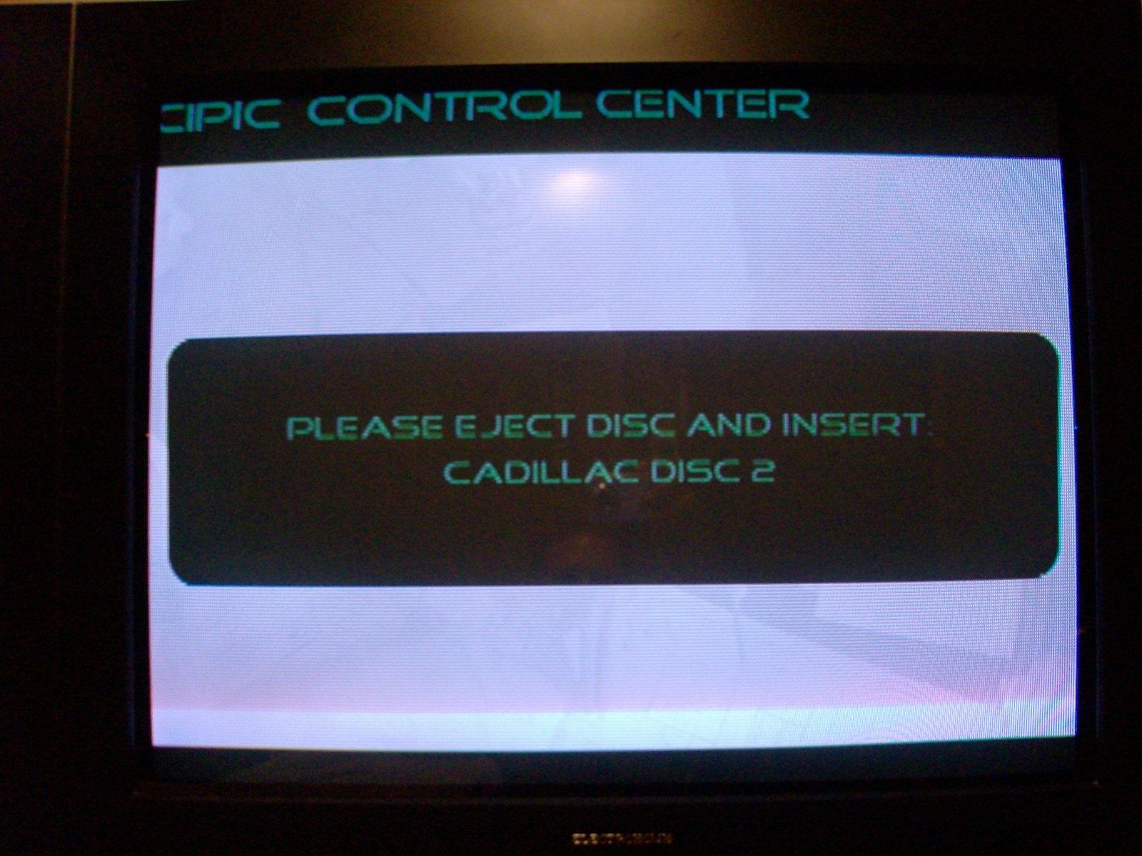

    A small step forward. After trying out yet another DVD drive (LG this time), I was able to get the Cadillac demo to this point after about 10 minutes of loading. This time I could hear the hard drive being accessed.
    Unfortunately it is asking for a second disc. Does anyone have the 2nd disc?

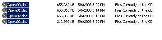

    Seems that your Cadillac DVD isn't complete.. It should contain 4 CD images, formatted with the opera file system.
    Like this:
    Opera00.dat (655MB)
    Opera01.dat (655MB)
    Opera02.dat (655MB)
    Opera03.dat (208MB)

    I downloaded the DVD image from the same site. The DVD itself is formatted with the UDF filesystem (readable with windows) but the CD image files it contains are formatted with the Opera filesystem (only readable with M2 devices, or the tools you're referring to).
    What do you mean with 'not been able to boot it'? The fact you get to the installation screen means it booted atleast the Opera00.dat image. Maybe you should also burn at a lower speed, say 4X

    I should have been more clear in my wording. The Cadillac DVD is bootable (to the point where it asks for disc 2). Below is a screenshot of how the DVD looks under Windows. It appear to be the same as what you are seeing.
    At this point I'm wondering if my burn speed may be a factor. I wonder if there are read errors prompting it to ask for another disc? Just a wild guess at this point.
