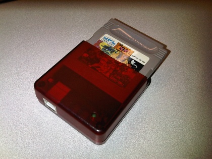

    You can probably get a SmartBoy copier and backup saves that way. Just plug it into the docking station, plug the USB end into your PC and use the SmartBoy software provided. Here is what I am talking about:

    Great news though, Smartboy Carts are available once more from www.smartboycart.com. I ordered one and am awaiting its arrival.

    I know you said no Mega Memory Card, but hear me out. I use the MMC with a GB USB 64M cart (http://store.kitsch-bent.com/product/usb-64m-smart-card). I will play my game like normal on a cart, back it up to the MMC, plug in the flashcart to the MMC, WRITE the .sav onto the flash cart, and then copy the .sav from the flash cart to my computer.
    I've been doing this since 2011 with no failures, mostly for my Gameboy Camera. If you're worried about the MMC failing - play, save, back up, copy to flashcart, save to computer...THEN wipe the original cartridge. This way incase of the rare failure of either the MMC or the cart, you will still have your save on your cart to try again. *shrug* Just a thought.
