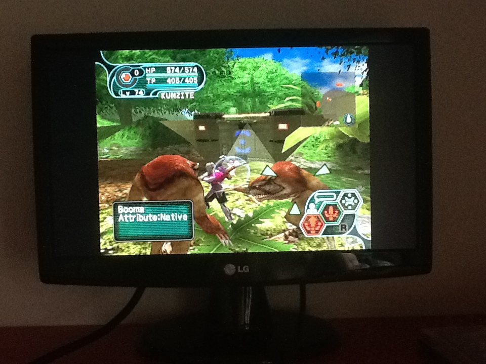

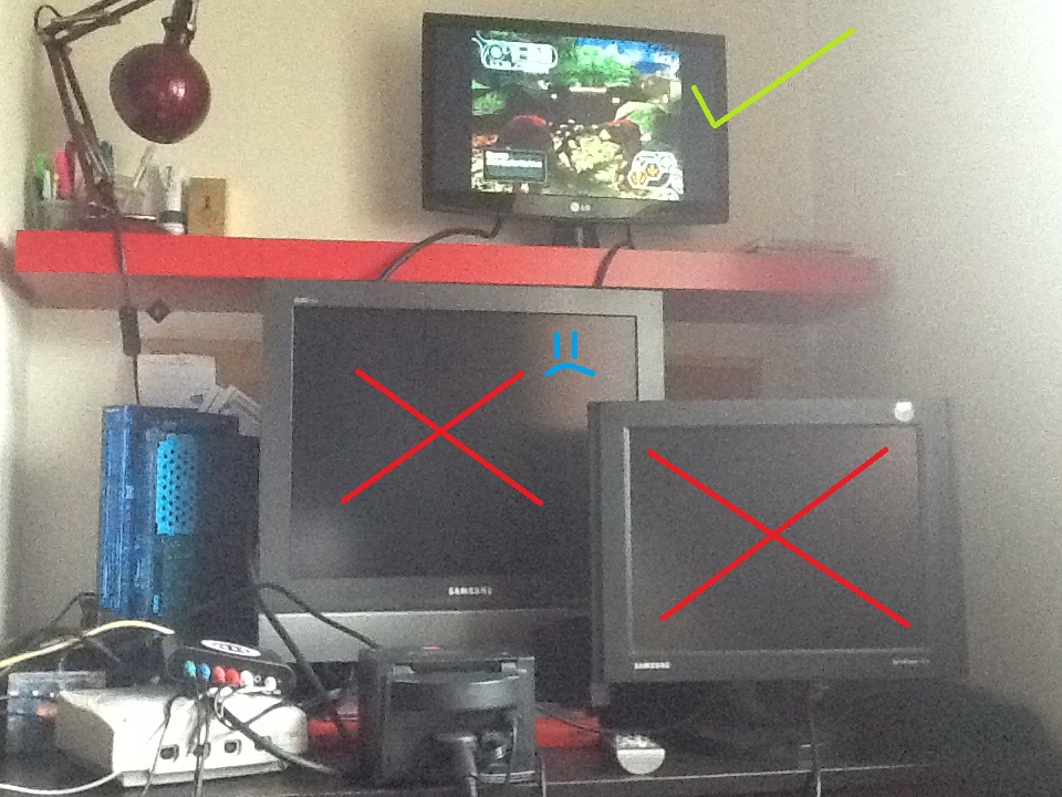

    I've tried with 3 different screens. It worked on my PC screen lol, so the HD box is definitely working, which is a good thing. Although the others don't support the signal sadly.

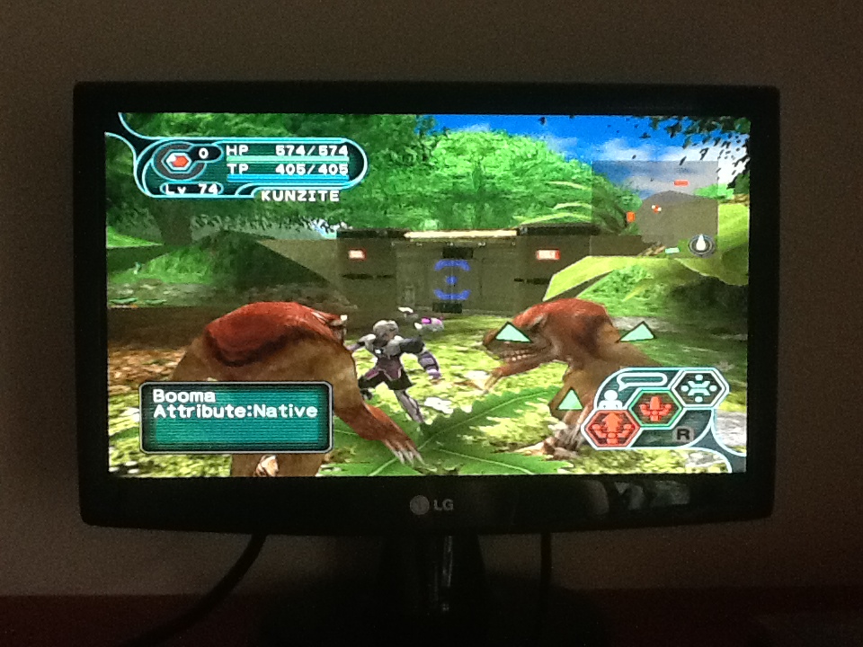

    Here's some pictures:
    Later today or tomorrow I'll upload some shots on my HDtv to see how it fits with maximum resolution.
