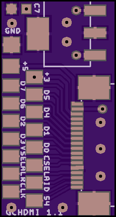

    If all goes well, I will sell kits. You'll still have solder this connector to the a/v port pins:
    If I sell kits, I will redo this board, because these pads are pretty tiny.
    I do plan on making the project open source as well.

    Cool I want to get the mini HDMI footprint was thinking about using that on my board should reduce the PCB size by about 5mm hopefully. Be careful you dont short any of the gamecubes digital ports lines together or to gnd / vcc double check everything before you switich it on. I have killed to cubes doing that so be very careful first time round good luck !

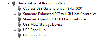

    Thanks for the heads up. I did get everything together. However I could not get the SPI programmer to start up in device manager. It just says unable to start the device with the driver you modified. Not sure if this is a windows 10 issue, or the programmer, since it was a cheap alliexpress buy.

    oh pants :-( did you get a Lcsoft CY7C68013A (cypress FX2LP) Mini Board ? if so with J1 disconnected did you get the following in the windows control panel (cypress USB generic driver) ?

    Yes I got the correct one. My JP1 is actually tied internally. After the programming I was going to cut the trace. Then install the cap. I did pull out my XP machine last night. I do have a parallel xilinx jtag programmer. It fails as well. Cant ID the chip. So there much be something wrong with the design, or one of the chips is bad (unlikely). I'll do a quick check again on the jtag/spi connections to verify everything is going to the correct pins...

    When you have time, could you post an image of the main pcb with respect to the cube, please? I'm so curious about the dimension, e.g. does the HDMI connector exit from the rear case?

    yes the hdmi will exit the rear of the case. The pcb width is designed to fit exactly in this spot circled below:
    The three holes will be use to mount the device to the metal shield. You will have to drill holes. I haven't cut into my case yet, because I want to the design working first, before I waste perfectly good case.
