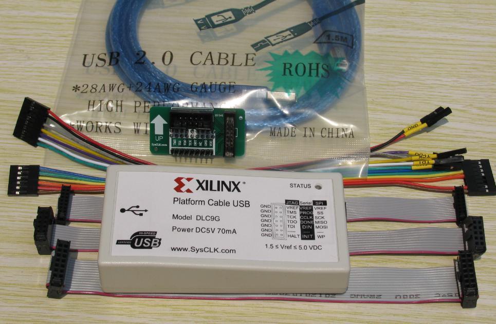

    For the Xilinx Cable you have, this is the one I have:
    Thank you.

    @pr0cess0r Hello I tried to Flash the Shuriken Video Board today by following your video, but it said Program Failed in Red :( I followed every step you did, and when I hit program, it fails. It said SPI Device not found. JP1 Not Bridged. Xilinx Programming Cable is DLC9G. Files freshly downloaded from GitHub GC Video 2.3. Here is my log:
    Now I am almost certain it is not a hardware issue on the board because the LCSOFT happy_bunny method recognizes the M25P40 chip. I am thinking it might actually be IMPACT 14.7. I see you are on 14.5, and you programmed yours successfully. I saw this link on the Xilinx Forums talking about SPI Flash Fail with 14.7, but 14.1 it was ok:
    https://forums.xilinx.com/t5/Configuration/iMPACT-14-7-SPI-flash-FAIL-iMPACT-14-1-OK/td-p/
    I think I am going to install 14.5 to test that out and go from there. Any thoughts?
