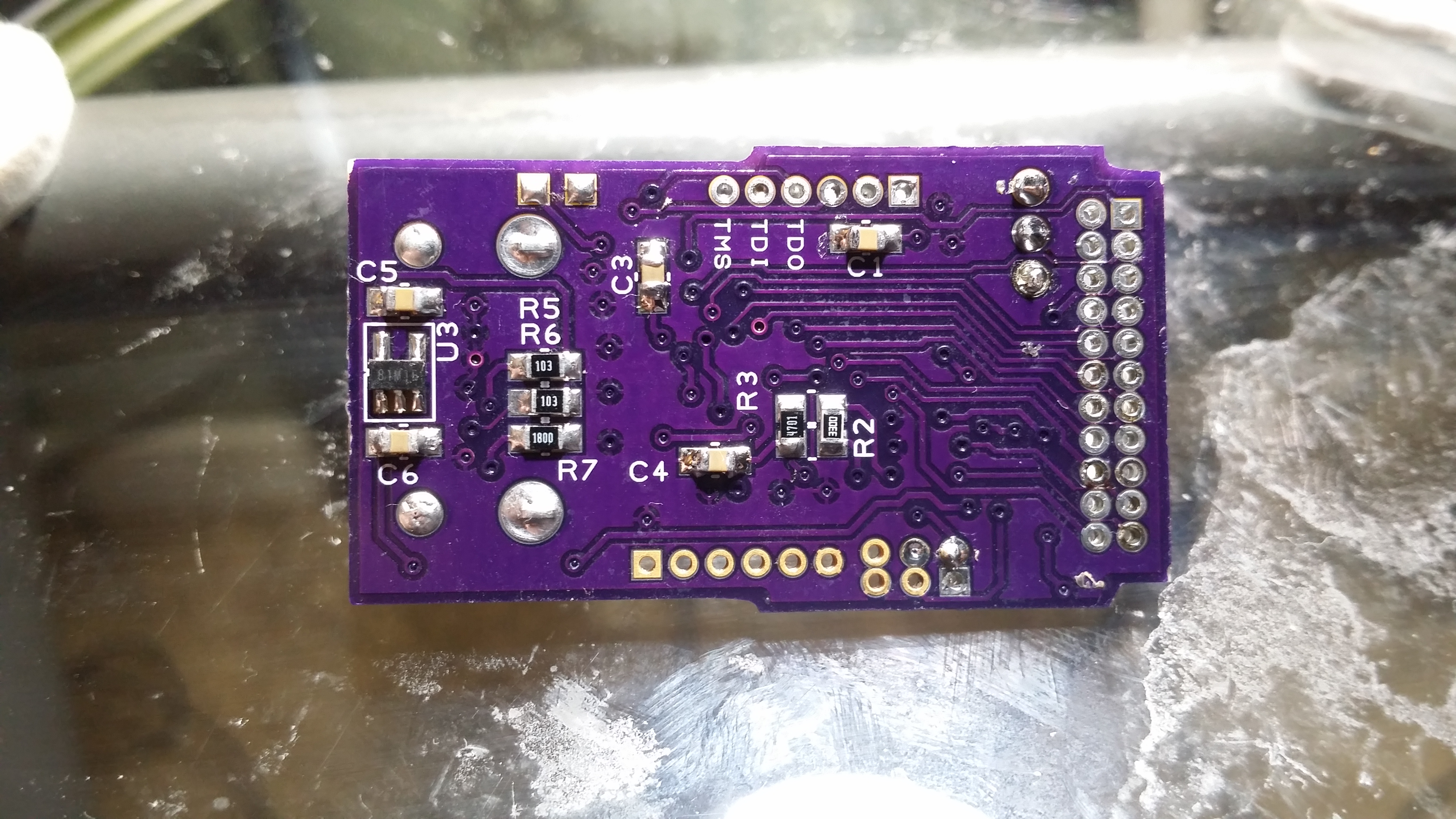

    I have a working Shuriken V3 tonight.
    My problem from day 1, was physical orientation of the direction for R2 and R3. I fell for the same mistake on each board I built. Please review below.
    My brain coasted over R2 and R3 for all 3 Shruiken V3's that I built.
    I believe that I can see what caused my brain to be tricked. Possibly the same thing @pr0cessor experienced.
    The orientation of the Text for every Resistor and every Capacitor, matches the direction of their corresponding component, except for R2 and R3. Their component is horizontal, while their text is vertical. A lame excuse I am sure, but as you can see I fell for this simple oversight 3 different times, each spaced weeks apart. I did not build each of these on the same night. Nor did I refer to my previous work. I just sat down on separate occasion and assembled them.
    So it is of course up to you, but I would recommend rotating the orientation of the text for R2 and R3.
    I believe this explains why I failed to program via JTAG, and why pin 54 never went high after Direct SPI programming. I was absolutely mistaken when I claimed it went high in an earlier post.
    I am looking forward to finally moving forward and trying this out. Thank you for all of the help between this thread and other places.

    Awesome news :) yer I placed the text in that direction to avoid a text over via pcb design rule error but I can see the confusion will add a section about it on my website.
    kreg likes this.

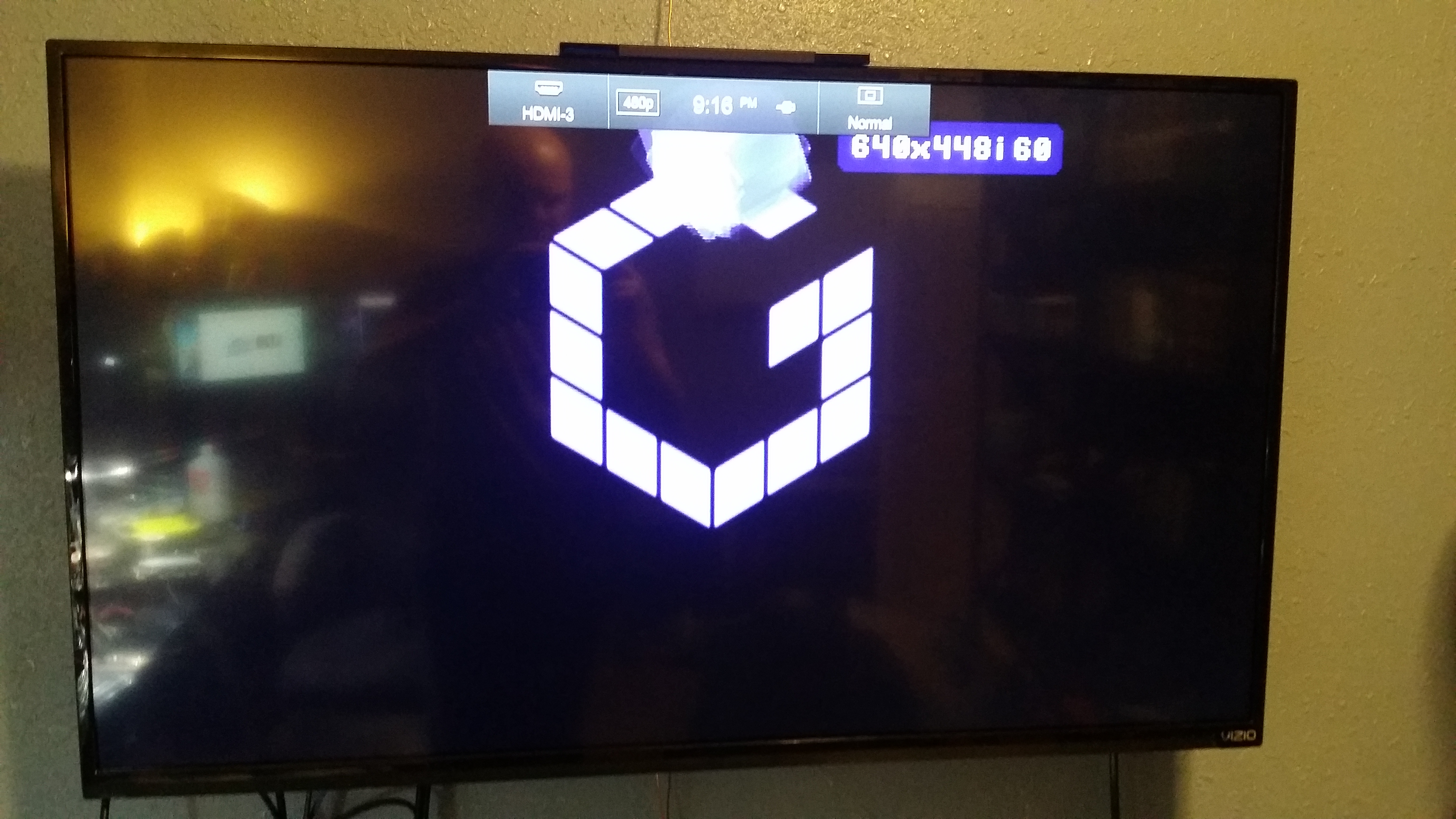

    Gcvideo on my Wii
    Marmotta, Unseen, Bearking and 3 others like this.
  11. Pa0l0ne
    Pa0l0ne Member
    Nov 24, 2013
    22
    This is how it perform:
    zeruel85 likes this.

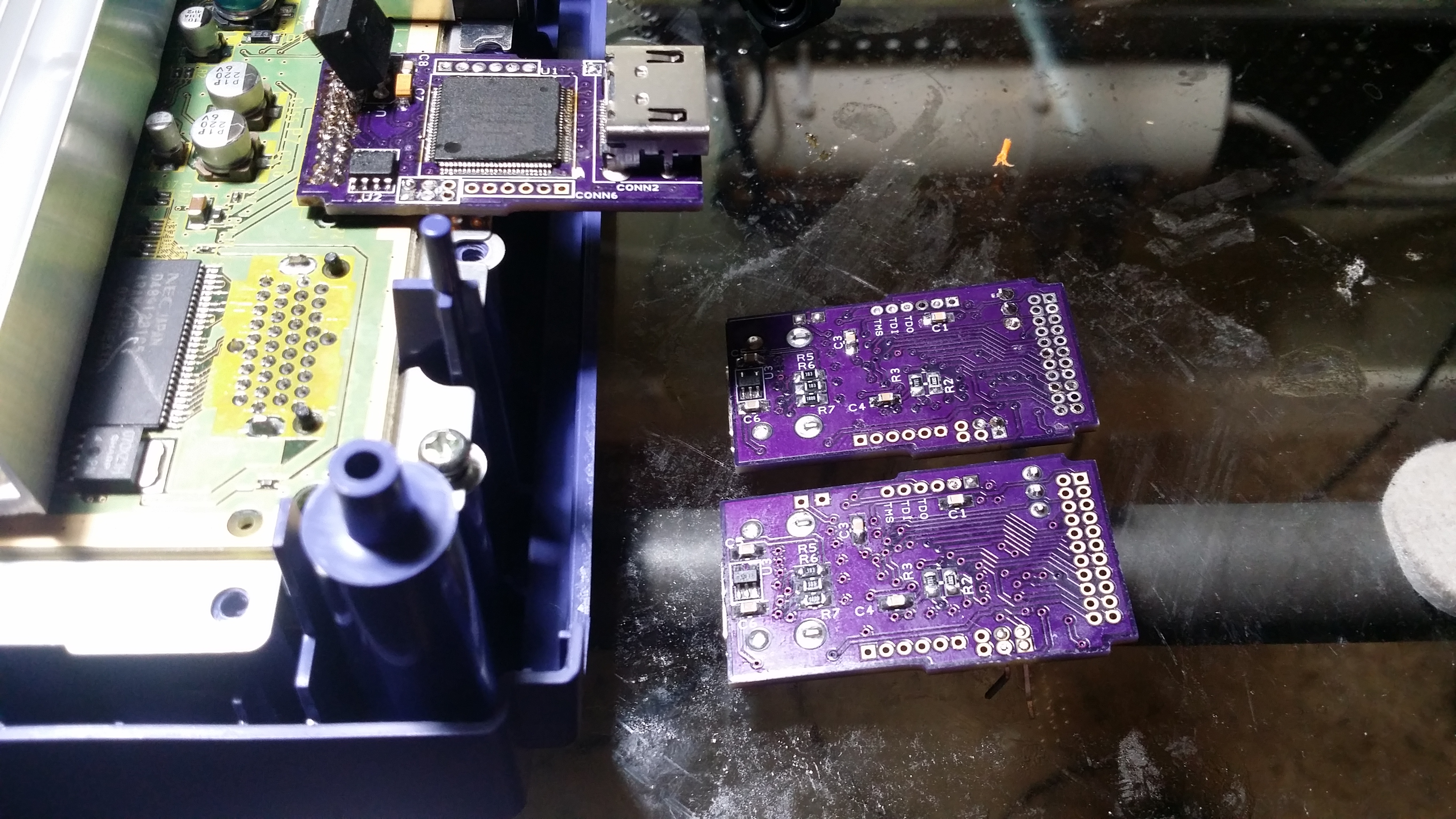

  13. citrus3000psi
    Nov 8, 2013
    1,051
    418
    I have a board coming soon from osh park that will hopefully solve that problem.

    22
    Did you think about flat cable like ultrahdmi on n64?
  15. citrus3000psi
    Nov 8, 2013
    1,051
    418
    That board is using a connector like this: https://www.digikey.com/product-search/en?keywords=455-1814-1-ND
    But I have thought about flat cable. Getting a flexible PCB made from a fab house is $120-$140 minimum. I have intentions of trying to build one myself with a dupont product called Pyralux. But have not gotten around to it. They say it works best with a solid ink printer, but I may try the basic toner transfer method with glossy paper and a iron. Not sure how .5mm space traces will come out.
