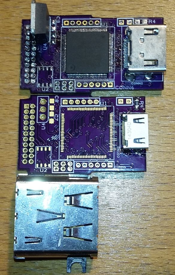

    My boards arrived from oshpark, put in my Gamecube for a test fitting and I somehow messed up the measurements for the hole placement :oops:. At least it means I've a bit more room to work on the board when I re-do it.
    Also managed to mess up soldering one of the edges of the FGPA, so I've had to order a new one :(

    Yes, but the QSB I designed for the digital AV connector hasn't arrived, as I ordered it as a 0.8mm board.

    dont have a clue if the mini hdmi connector works need to check at the weekend but at least I got the boards
