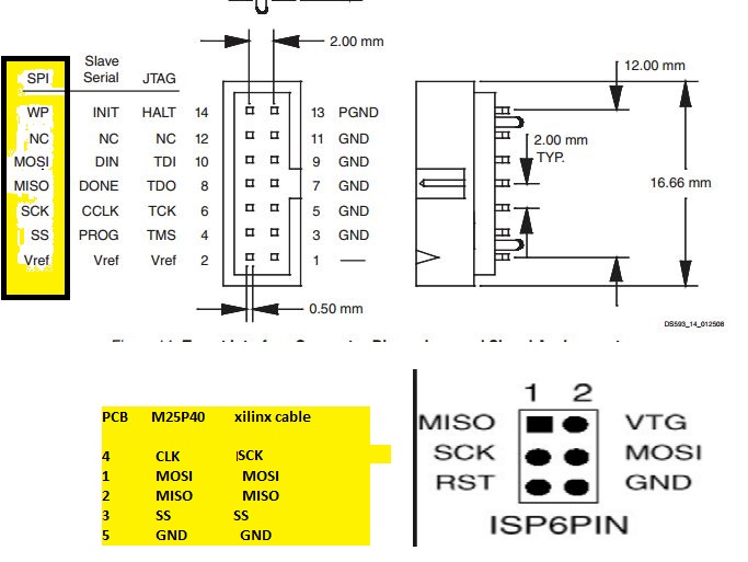

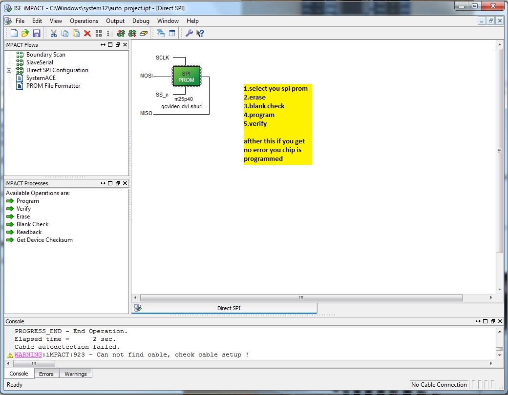

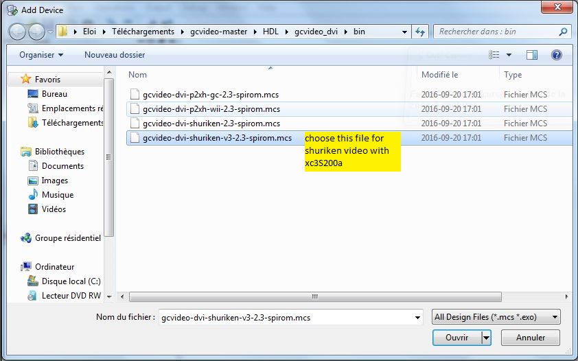

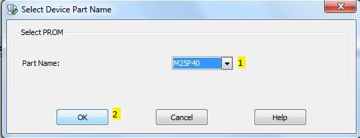

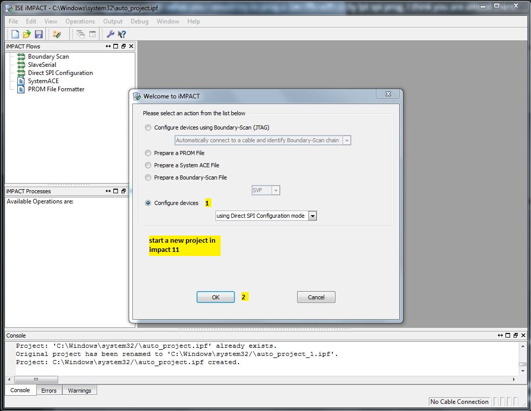

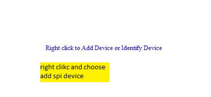

    If you detect the xilinx chip then you are un jtag mode so you shoulf not jump jp1 and then you will be able to prohgram the spi flash indirectly if you jump jp1 then jtag is not possible anymore and that why it fail.
    If you want to use direct spi programming first make sure that you are correctly wired then jump jp1 and power the board. You will need impact 12.1 or older to have direct spiprogramming option. Im downloading it now and will try to share ity with you.
    Here is a small guide:
    connect xilinx interface
    power the board with JP1 closed and follow those step in impact:

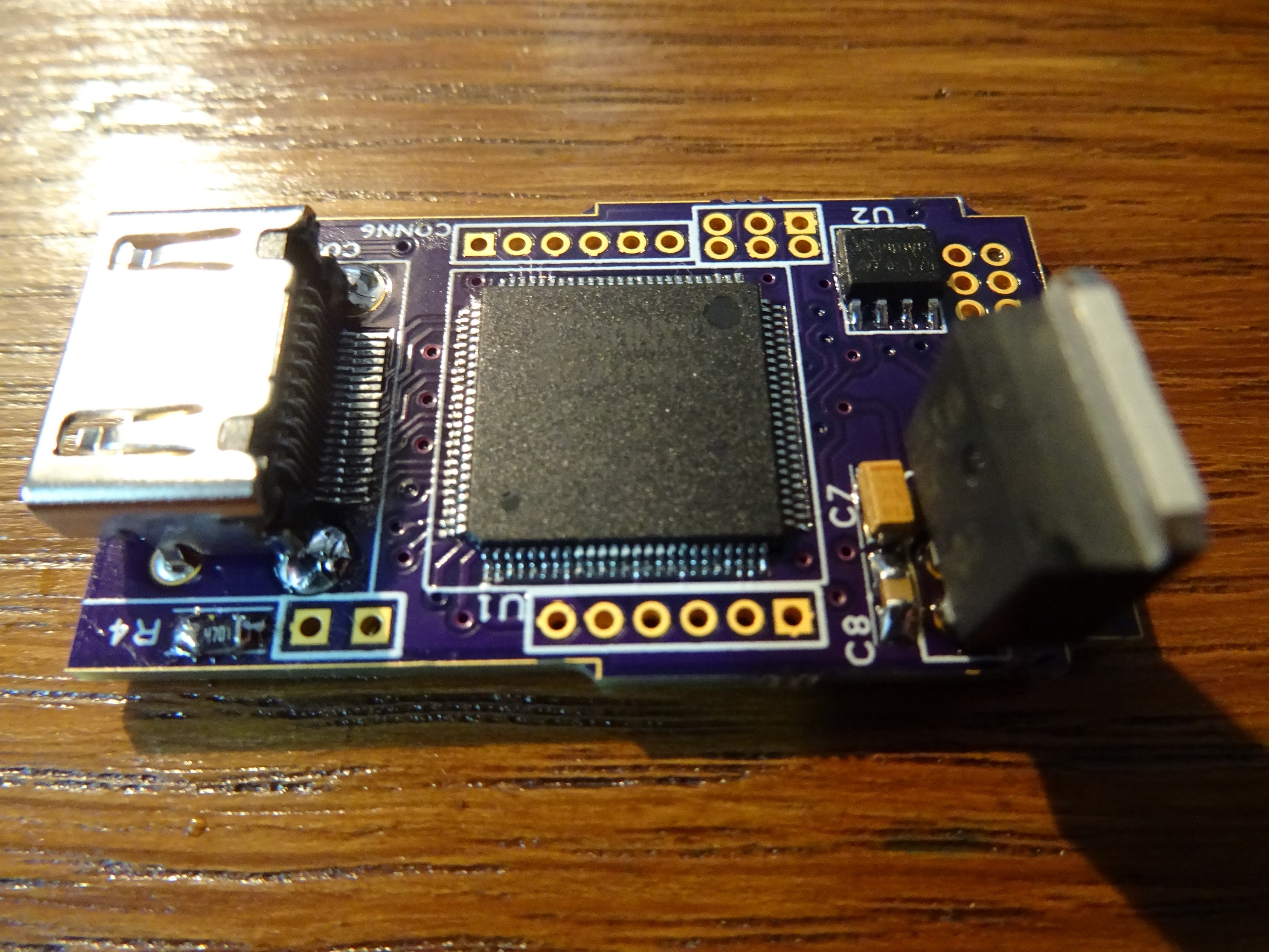

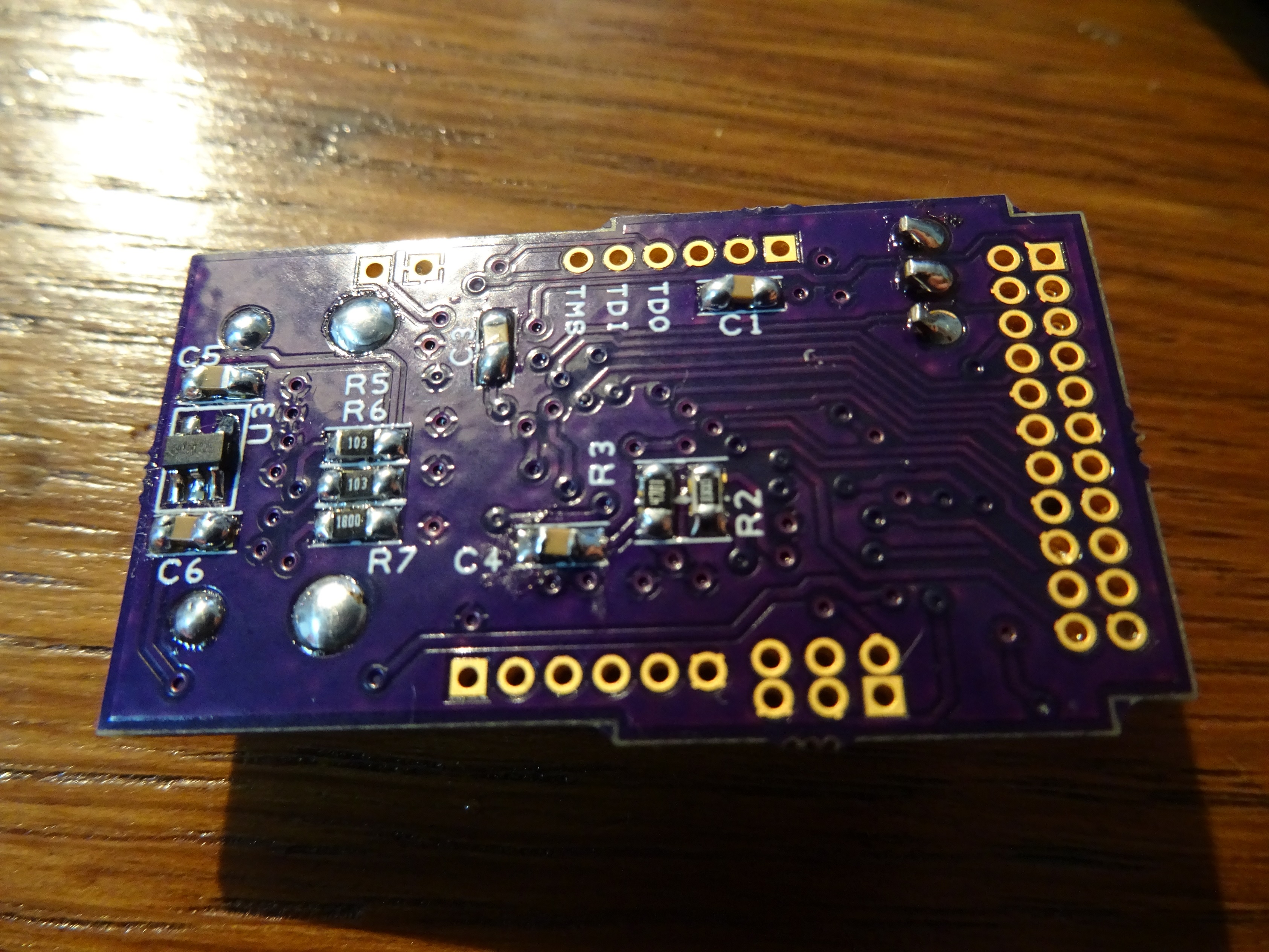

    Finished my first shuriken V3. I must say that the FPGA soldering is not so hard but hdmi is harder to solder in place. I will program it tomorrow and try to install it!
    I dont know how i will mount it to the gamecube port. i think i will use hdd ide cable

    Afther lots and lots of work it dont work. It boot since i get about 3V on pin 1 at gamecube and if i remove the flash rom i get .8V. Si i think it load the software. but nothing on the tv.
    I look for any short but cant see anything .
    Do i need to put the cap at jp1 or not ??
    any idea ??
    the bin file i get to program it is 146 Ko is this normal?? i padded with FF to 512 but the chip is 8x512 why my programmer did not pad it all ?
    im a little disapointed now.

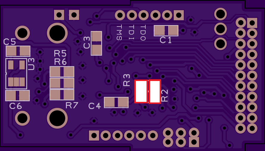

    Split up the task into three parts, first power the boards from 3.3 volts then program it and check the done pin it's connected to r2 make sure it goes high. Next wire up 3.3 volts the 12 volt and c sel and clk then connect the tv you should get snow.
    Finally and carefully solder up the data lines check nothing is shorted power up you should see a picture on the TV.
    pr0cess0r likes this.
  15. pr0cess0r
    pr0cess0r Spirited Member
    Oct 22, 2016
    109
    I found 2 big mistake from myself.
    1. 3.3V shorted to ground on the fpga ( whas not at the begening but with all my test.
    2. R2 and R3 in the wrong direction.
    so tonight i will test with 2 wires to see if done pin work. then add other signal to see if i can get snow.
    Thank you happy!
