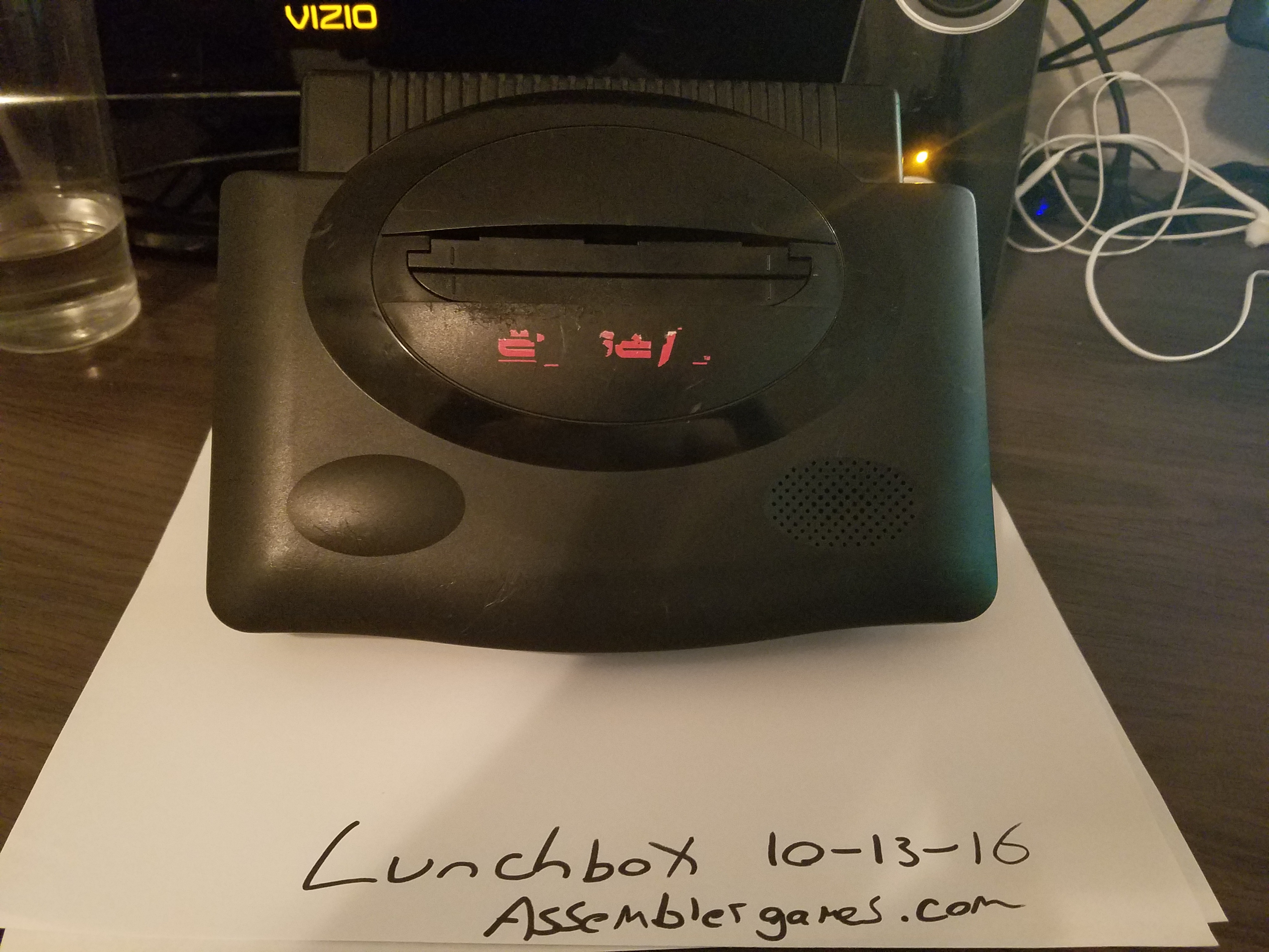

    Here you go. Its not in pristine shape but its all there.

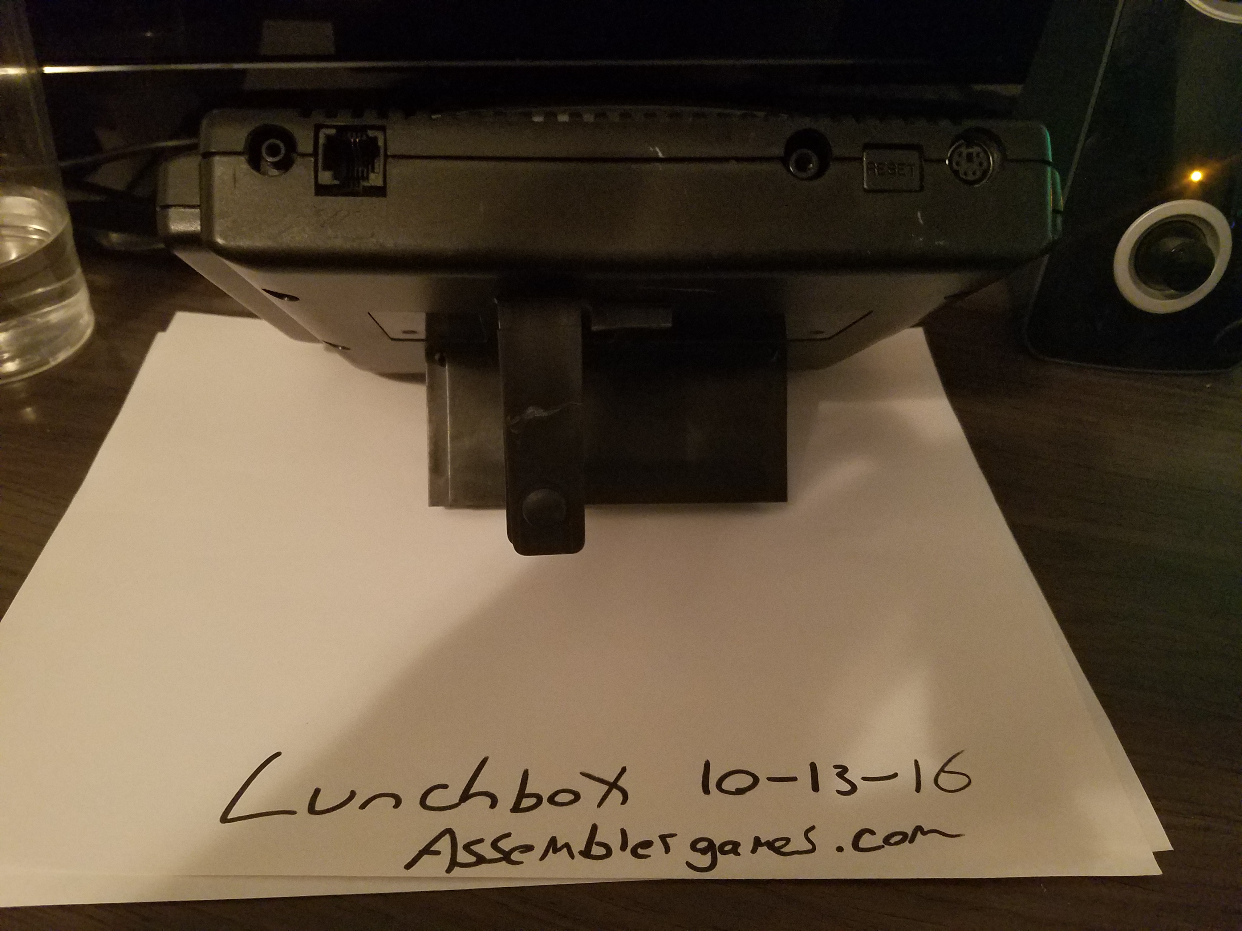

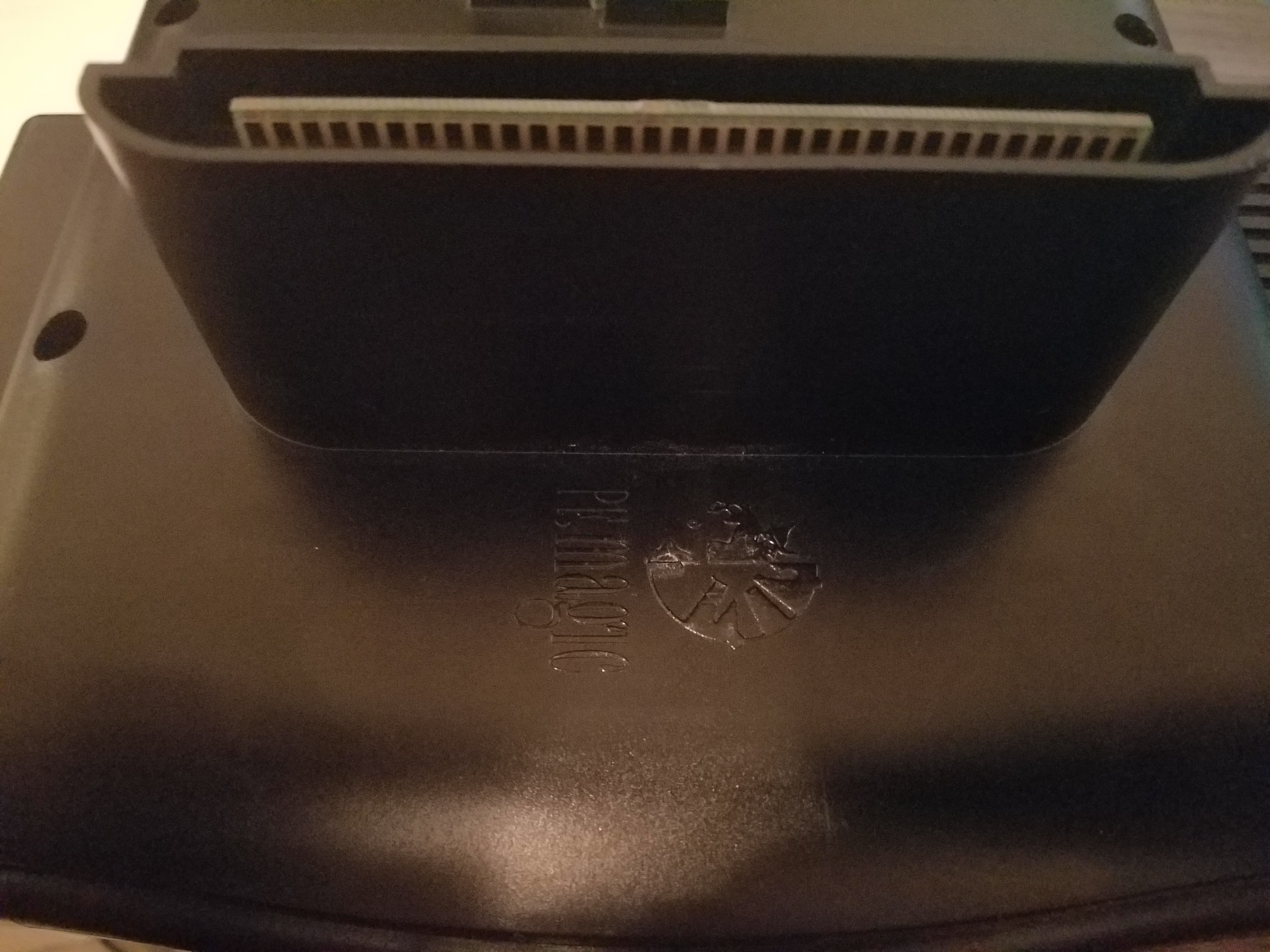

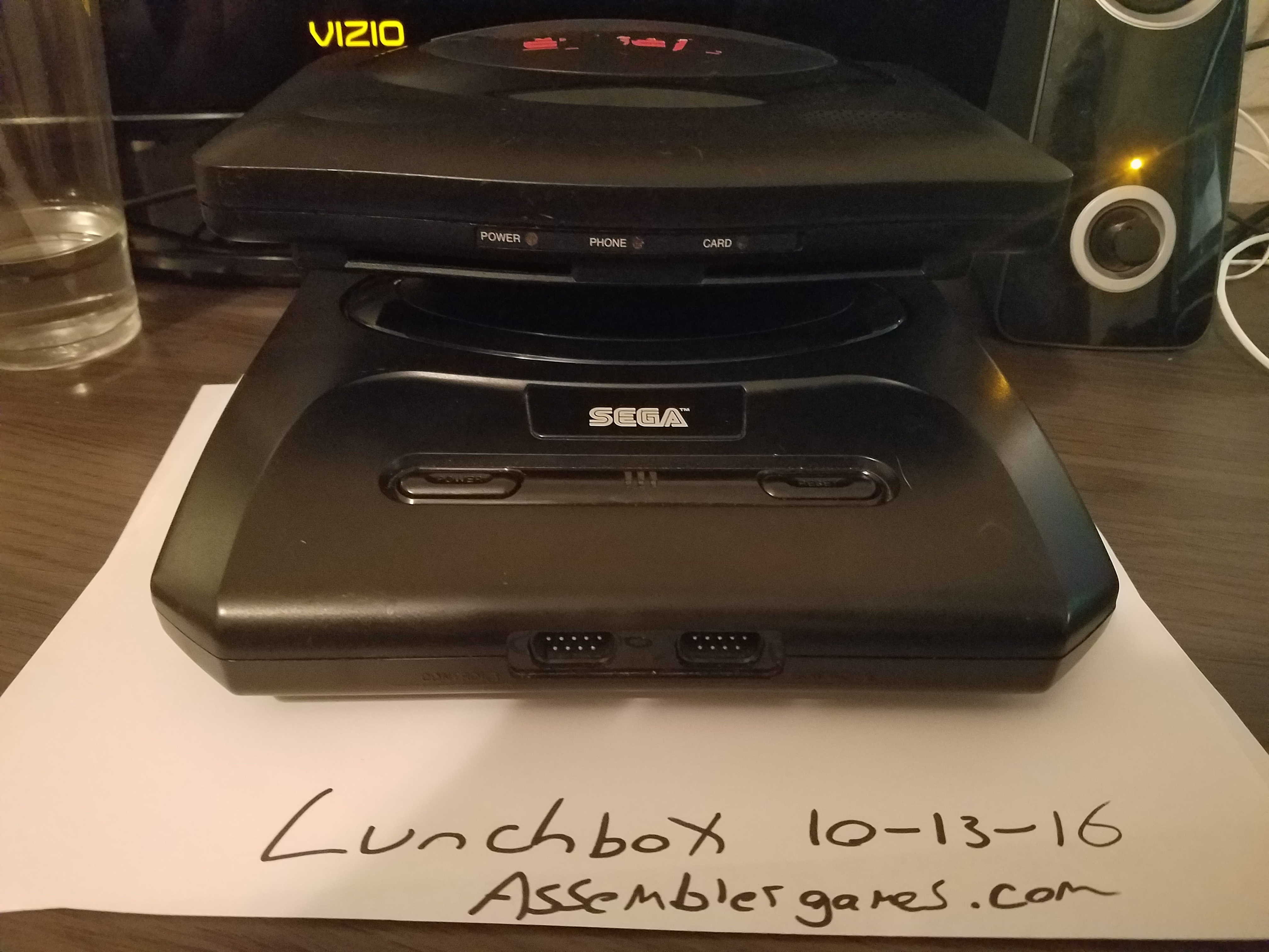

    Here are a few more pictures. If i power up the genesis model 2 with it plugged in with or without a game the Power and Card LED indicators on the front will light up but it acts almost as if i don't even have an AV cable connected to the TV, nothing really happens on the TV. Unsure if its looking for a specific game to be plugged into it before booting or if there is truly something wrong with it.
    I'm a bit hesitant to take it apart honestly. If by ANY chance someone has one of these and can chime in, please do. id love to hear if i'm just overlooking something.

    In regards to the connections. VERY possible it needs a power supply. It looks a bit weird on the back as i have what appears to be a PS/2 style port for a keyboard which is shown in a lot of the promo posters, an audio Jack for headphones/microphone is my guess and then the RJ11 port and another port similar to the audio jack but looks to be slightly smaller. This COULD be a power jack but not sure. It would make sense that the genesis cart port might not have enough power i guess to power this thing up entirely.
    Edit: Now that i think about it, the Xband modem didn't need its own power supply and had an ASIC and modem in a cartridge form. Its possible maybe this thing needs some looking at.

    Ok, so small update here. I did manage to get ahold of somone that had worked on the modems. It definitely had its own power supply. Rating/specs are un-know however. I'm pretty sure this is all its missing more or less... It should work as as pass through device unless the game queries for the hardware and attempts to utilize it.

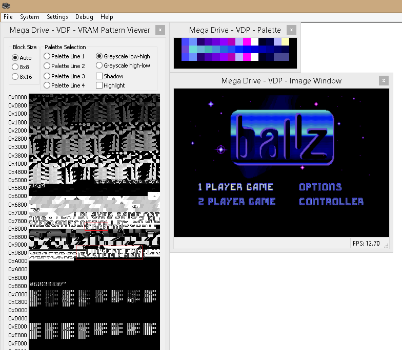

  19. Lunchbox
    Lunchbox Active Member
    Jul 20, 2016
    46
    39
    Brutal paws of fury by GameTEK is the other. GameTek, PF Magic, Sega, US Gold were listed as companies that had working titles that were working with the modem as per a magazine article i saw online recently. There might be more games, i just havnt had time to look. EA games was mentioned as a company that was looking into making their games compatible with the modem and they had a few modems when Ballz was being developed. It wouldnt suprise me if any EA Games released around 8/94 to 12/94 or even early 95 might have code as well....

    Also the ones above i listed (pf magic, sega, gametek, us gold) were listed as having games that worked with the modem. i havnt looked beyond pf magic and gametek just yet and havnt exhausted looking at all the titles they made that were released around the end of 94 early 95 to see.
    I included the snapshots of what i found in the exodus emulator when looking at the VDP Ram.
