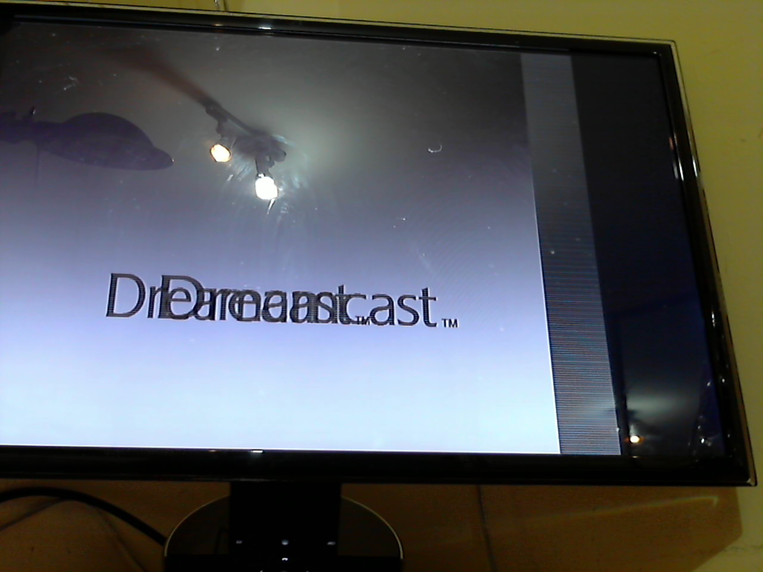

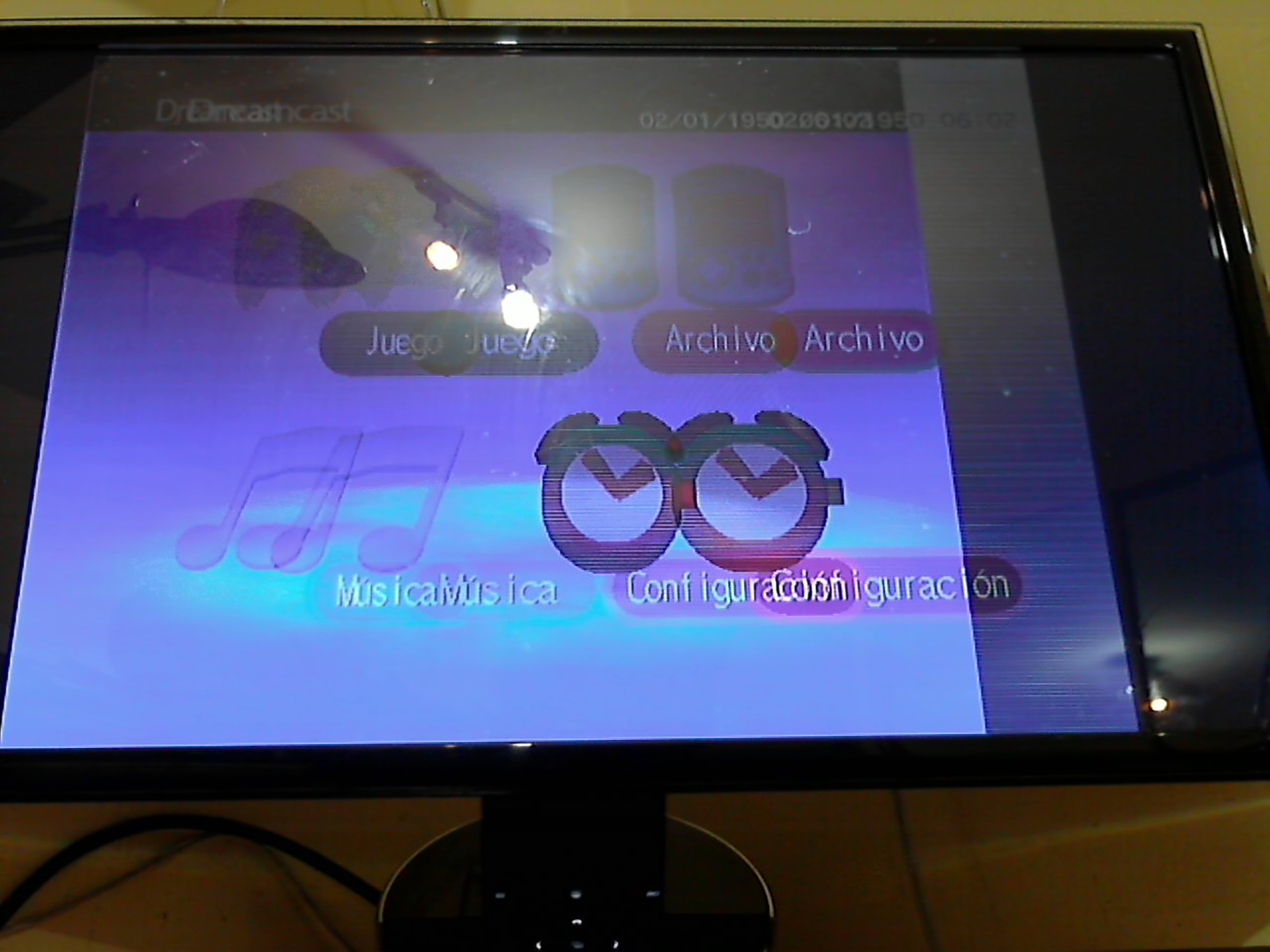

    I bought this product:
    VGA or Component Video (YPbPr) to HDMI Converter
    I connect the Dreamcast using a dreamcast vgabox, and i have ghosting problem, if i buy a better vga cable, can i fix this?
    If i use component video on my PS2, no problem.
    PD: I have the old Kuro DC VGA Box.

  2. dans87
    Jan 6, 2013
    359
    33
    sounds like its the vgabox that is the problem or a combination of the two together

  5. APE
    Sync issues. I doubt a better cable will fix this but buying a Framemeister probably will.

  11. Calpis
    Calpis Champion of the Forum
    5,906
    What components are in the VGA box? Are you using extremely long cables? Are you sure the DC is outputting 480p and not 480i?
    The Dreamcast outputs ideal broadcast-compliant video so the HDMI converter shouldn't tripped up by it.

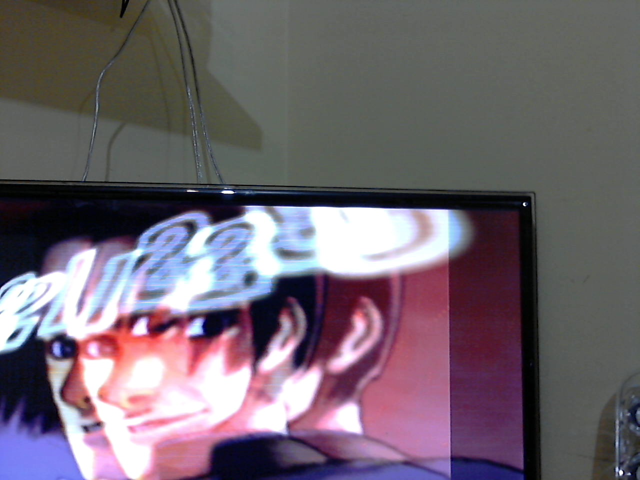

  12. Gromber
    Gromber Spirited Member
    Apr 4, 2012
    115
    30
    the problem is the converter only works in resolutions ending in 8... like 1280X768

  13. Calpis
    5,906
    That doesn't make any sense. The number of active lines in a video frame (the visible ones) are not the actual number of lines sent to the display or in this case the converter. A HDMI converter should at the very least support:
    480p (525 lines total), 720p (750 lines total) and 1080i (1125 lines total)
    480i is RARELY supported by TVs over HDMI. My guess is that the converter is receiving 480i and confused.

  14. Gromber
    Apr 4, 2012
    115
    30
    I tested the converter in a 360 with vga, and only works in the resolutions i said, if i select 640x480 i have the same problem... the hdmi converter is a shit....
    Dreamcast output is 480p.
