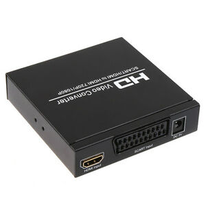

    I've never had any issues with this converter - very happy with it. I play most games at 720p and they look great.
    This is the model I bought from Amazon: Panlong PAL/ NTSC SCART/ HDMI to HDMI Video Converter Box 720P 1080P Scaler
