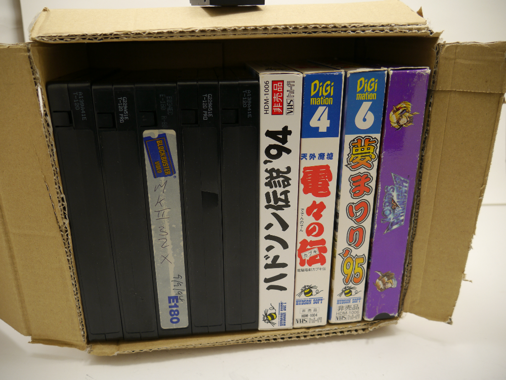

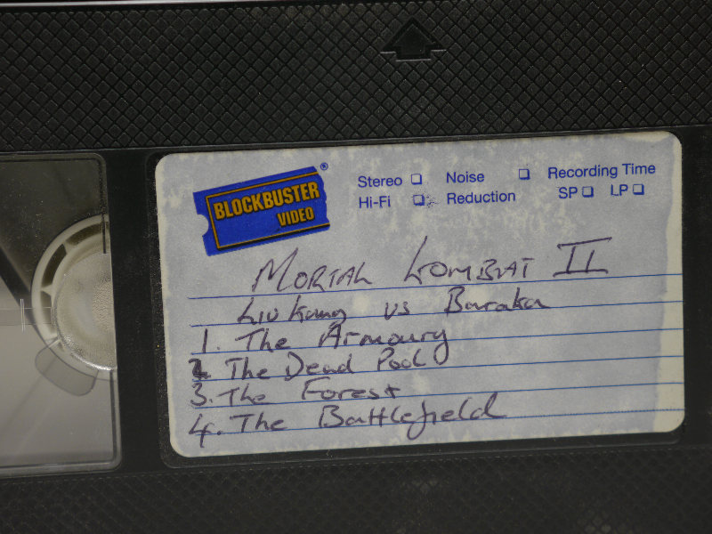

    I have six tapes of 32X and N64 beta play testing from acclaim.
    The titles read Mortal Kombat, Turok, a few others I am not sure
    about. I would also like to convert the H-Ten bomberman footage to digital.
    I don't have the equipment to do this, and there are far more affordable experts for this at
    digitalfaq.com. TheI estimate costs to be $20 per tape,total of $120 to convert the six tapes to properly timed and converted digital video.
    If you are interested in contributing, please use the donation button on the main page, and include the mesage "vhs conversion project" in the message field. All donors will get download access to the entire footage Vs the edited and reduced footage we will be releasing on youtube.
    Anyone who sponsors an entire tape will get a small gift by mail.
