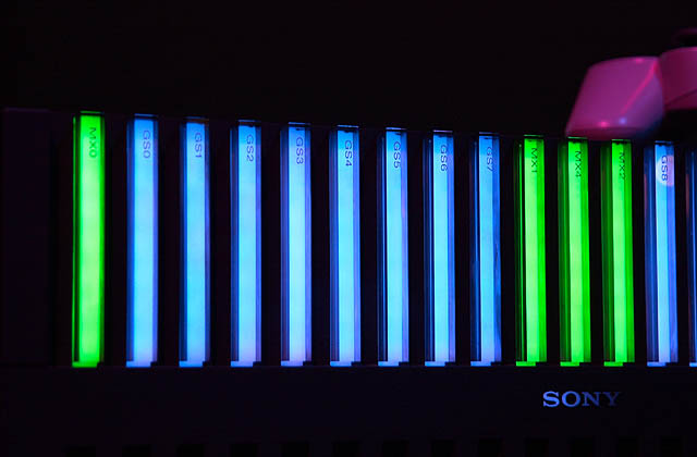

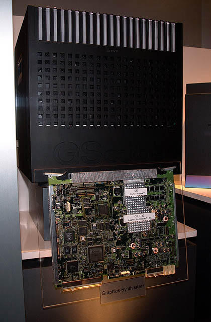

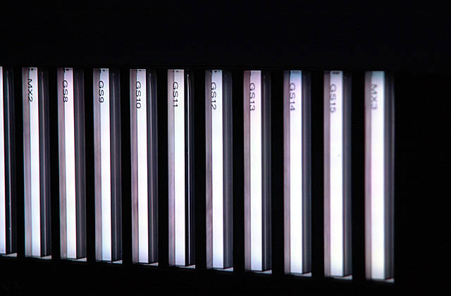

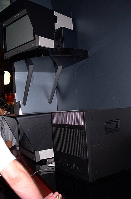

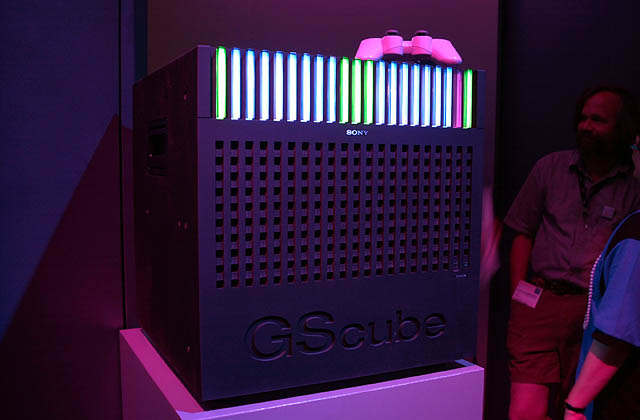

    The pictures from siggraph2000:
    [​IMG][​IMG]
    The color of the display reflects the processor state, blue for the Graphics Synthetizer at idle state, green for the MX マージャー (sorry i can't find a translation for this) processor idle too, red for the processors warming up, and white for the processors working near peak levels.

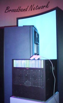

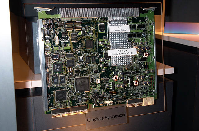

    [​IMG][​IMG]
    It seems that the gscube is not a standalone machine, it needs to be connected to a SGI Origin 3000 as a host.
    This picture come from the website of a SCEA employee.

  16. dickibow
    dickibow Intrepid Member
    Feb 25, 2005
    643
    OMG - they are feckin' huge!!!!
  17. Borman
    They're big, but the one picture has a perspective issue making it seem HUGEEEE

  19. Barc0de
    Oct 29, 2005
    11,205
    It is safe to say that at 48 Kilograms it's not exactly a gamecube (which weighs about 1Kg more or less)
    EDIT: You might notice the grabbing handles located at the sides of the monster, similar to those found on professional concert speakers - not that I would take it to a punk rock show :p
