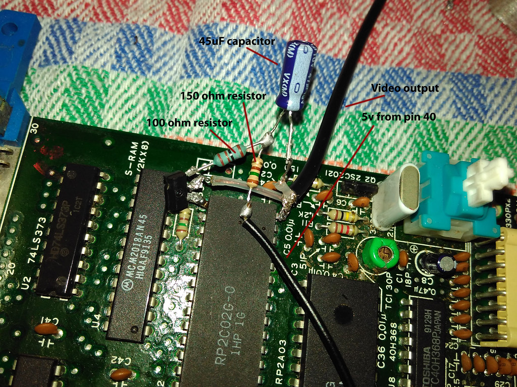

    I'm trying to mode an HVC-CPU-GPM-02 Famicom using the following tutorial:
    http://jpx72.detailne.sk/modd_files/fc/avmod.htm
    But I get no video output.
    Here are some pictures of my mod. DO you guys see anything weird?
    BTW I'm using a 9v 1200A negative centre Power Supply with an Everdrive cartridge.
    The everdrive cartridge seems to work as it has a led that turns on which tells me that the console is also on.
    Tried it on my projector as well and nothing. I have Famicom 3 boards, tried doing this mod in all 3 of them and nothing.
    I'm thinking and thinking but can't find my error...

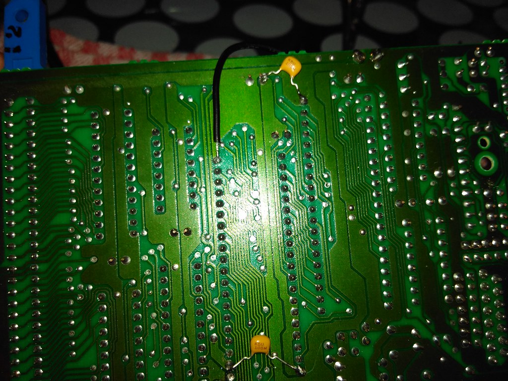

    I'm not expert but that capacitor on the bottom of second picture looks like it is touching that plane via the solder point on the right? I'd throw some electrical tape or something under it just to make sure it isn't.. additionally the wire looks close in same picture angle doesn't do it justice so it might be fine but I'd insulate it as well. I am not familiar with the mod personally but it says to cut the trace from line 21.. I see one cut at bottom of image 2 don't see the other just making sure you did it. Also on closer look on image 1 the transistor is it resting on the chip or the resistor under it? those could be causing shorts. I'd check those things first
