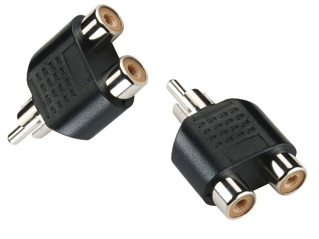

    You can make it "pseudo-stereo" if you want but that involves some more work. This just covers the basic AV mod.
    Or you could split the signal from the audio RCA connector if 2 audio cables are important to you with this thing.

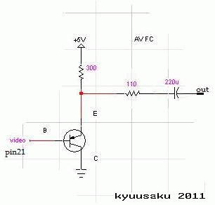

    How would one use this circuit:
    in regards to where the jumper is? I plan on using the circuit but don't really plan on drilling two holes into the system if that above method is cleaner. Or do I just cut some trace that connects to the jack closer to the end.

    I would use this since this is what the av famicom uses.

    But I want to connect any of those circuits TO that port in the back with little mess as the guide above demonstrates so I can use that port instead of drilling an extra hole.
