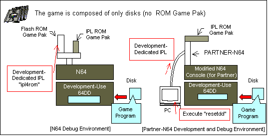

    As the subject says...
    I am having some problems getting the damn thing to boot. I have the IPL ROM cartridge in the front slot of the DCC board and a v64jr (6102 jap boot card) with the ipl4rom loaded onto it in the back slot of the DCC board.
    I am using a Japanese KMC N64. As far as I know it only has the 4Meg standard jumper pack but this shouldnt matter. It should be able to boot the IPL from the ipl4rom and give the memory error but it doesnt.
    How does the switch on the DCC board work? is it supposed to be in the position closest to the back slot (ipl4rom) on boot, and then flipped into the other position later?
    Does anyone have any ideas on what has to be done to start it up?

    Im not sure what you mean. I have the N64-Joint in the KMC N64 unit and the DCC board is connected to the N64-Joint. The IPL ROM is connected to the front slot on the DCC board and I have a v64jr instead of a flash cartridge in the back slot on the DCC board. Exactly like I think it is supposed to be:
    ANY help would be greatly appreciated.
    If no one has been able to start it this way...has anyone been able to start it with the partner-n64 cartridge and with "resetdd" from a computer?
