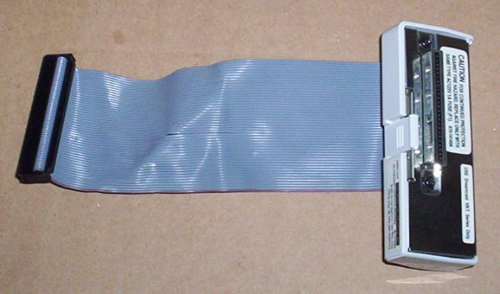

    As the topic reads, i'm wondering if anyone has successfully made their own BBA's or somehow tricked the DC into believing a lan adapter is a BBA?
    I just had this thought that even a LAN adapter turned into an SD-drive would be so much faster than the current SD solution. And a LAN adapter telling the DC it's a BBA would also be gold..
    Is there any knowledge out there on these ideas?
    Found this intriguing photo:
    over on this site which doesn't explain much..

    I did come across some clones that used regular PCI adapters but there wasn't much writeup on it. The site seemed to be in Japanese too and we all know how well google translate works for long text...

    It was probably the same guy I posted some stuff from, jj1odm: http://jj1odm.qp.land.to/ There's a LOT of stuff on there, but only a few are in english.
