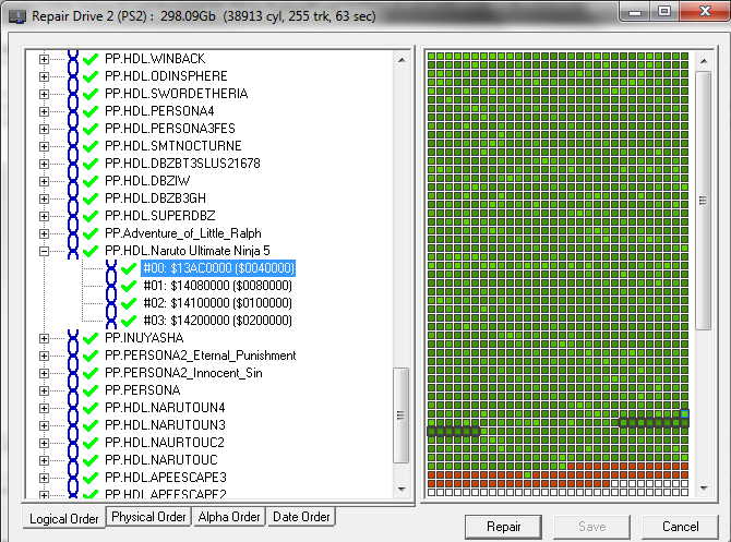

    If you have 80 games installed, you probably have more than 80 partitions. The maximum partition size is 1/32 of your disk's capacity.
    Probably 1TB maximum, as it is probably wise to not assume that it doesn't use signed 32-bit arithmetic.

    By "partitions", I was referring to regions of allocated space. Not whole installations.
    A partition consists of the main partition, as well as zero or more sub-partitions.
    So if you have a 2.5GB game on a 40GB disk, it may be allocated 3 partitions (2x1GB + 1x512MB) to give 2.5GB of storage space.

    HDDChecker should be able to do that too, but I made it not allow disks containing HDLoader games to be optimized because defragmentating a HDLoader game may break it (due to the LBAs being recorded in the HDLoader format). :/
    Does this mean that WinHIIP has some function for fixing up HDLoader games after they are moved around? It would seem most logical for it to have something like that.

    Oh, then I got a lot more partitions then 85... does this give any info of how many. It start slowing do on the Nartuo Ulitmate Ninja 5 but the PSone games (don't have HDL in name) don't slow down. I got 84 PS2 games on it, plus 5 PSone games.
