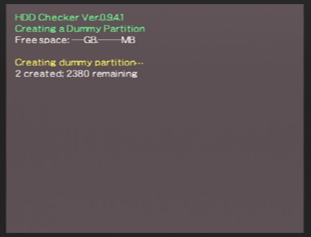

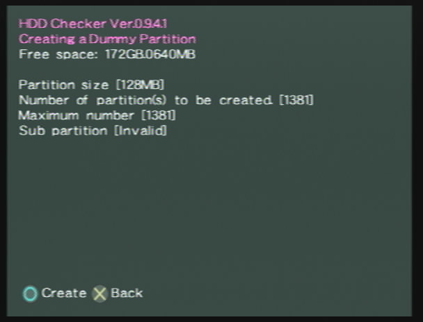

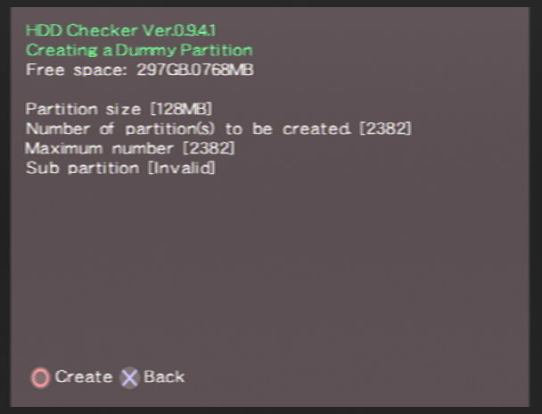

    Hey guise !
    I'm about to go to bed now, and as I don't liek wasting my time sleeping, mah PS2 will suffocate the hell out of it's expansion bay whilst I'm zzzzzz:livid:.
    Here's the funky maintenance task :
    The creation of 2382 partitions of 128 MB:stupid:.
    Let's play a little game : Guess what horrible wreckage will come:topsy_turvy:.
    Suggestions :
    1) HDD Checker will freeze at "255 created"
    2) HDD Checker will freeze at "999 created"
    3) My NIC will die
    4) My HDD will die
    5) My mobo will die

    Mmmm, nope, since it has passed the partition No.361, the case 1 won't happen:very_drunk:.
    EDIT : Oh f*ck, it became slow as hell. Something like 1 new partition every 40 seconds.
    EDIT2 : HDD Checker partition names and title0 have 3 increasing-digits (from 000 to 999). I vote number 2. Currently at partition No.413.
    OK now I'm goin' to sleep...

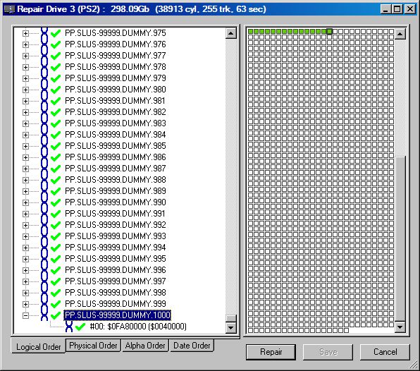

    :applause:, 1000, not 999.

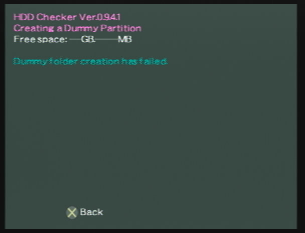

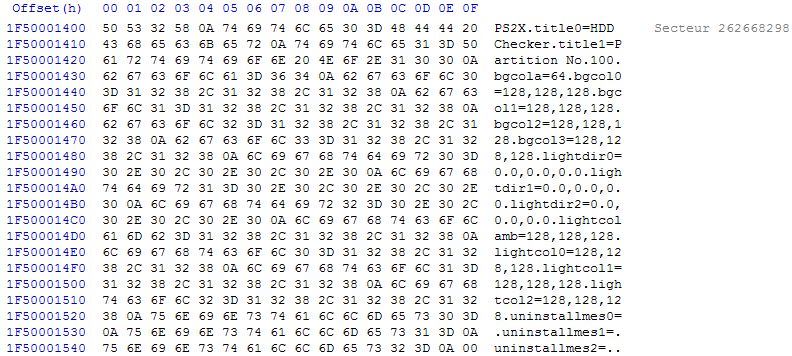

    I thought Zony devs would limit that variable to 999, since it also increases in icon.sys and info.sys, but they didn't. And if we go the PP.SLUS-99999.DUMMY.1000 partition what do we find ?
    partition No.100 instead of partition No.1000. Lazy programmers, HDD Checker doesn't add a char to the icon.sys. Anyway, official stuff weren't designed to operate >137 GB so we should not get up to 1000 partitions using Zony's HDD.

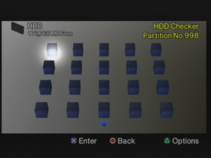

    I've inserted a game disc in the hope HDD Checker uses it's ID for creating partitions.
    After this screen I had the failure message... Hum, I'll have to hexhack HDD Checker so it doesn't create PP.SLUS-99999.DUMMY partitions...

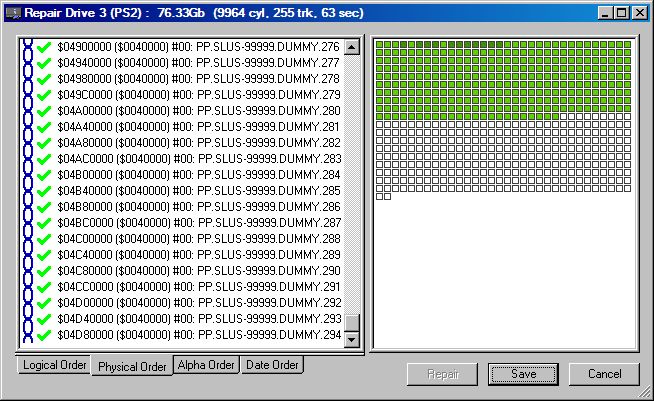

    EDIT : Alright, I've found where the lag occurs with my Maxtor 80 GB drive.
    [video=youtube_share;DvZqIJcfrG0]http://youtu.be/DvZqIJcfrG0[/video]
    What you see in this video is : The browser lags / I delete the offending partition / I reboot / There's no more lag.

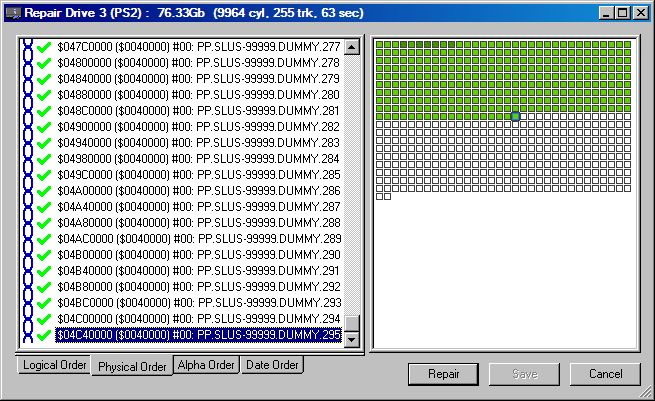

    The last non-lagging PP partition is 295th (PP.SCUS-99999.DUMMY.294) at sector 79691776.
    The first lagging PP partition is 296th (PP.SCUS-99999.DUMMY.295) at sector 79953920, shown in this pic :
    Any partition after the first lagging partition also lags.
    IT-DOES-NOT-MAKE-F*CKING-SENSE. Yesterday I've filled a 320 GB HDD with 8 GB partitions, ENTIRELY filled, and got no lag at all:dejection:...
    So, what should I try now ?
    Let's see if I can reserve a LBA range with a __ (system prefix'ed) partition and if it does something else than a stupid lag in the browser.
    EDIT 2 : Then if it's not a matter of partition quantity and not a matter of LBA... ...what the hell's that lag about ?

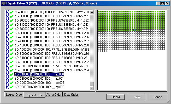

  19. krHACKen
    krHACKen Enthusiastic Member
    Oct 24, 2012
    571
    376
    I don't know, as I didn't mess up with the PSBBN for a long time.
    Another 80GB HDD.
    The lag occurs at the very same LBA. I've renamed 4 lagging partitions as __lag.### so they are not listed in the HDDOSD HddBrowser :
    [video=youtube_share;_m6Gvr1Wfz4]http://youtu.be/_m6Gvr1Wfz4[/video]
    See ? The partitions are hidden as well, but both Ps2Browser and HddBrowser still lag (there's a delay/latency, don't know how to call this) accessing the HDD (while trying to calculate the available space ?).
    I also tried to replace the last non-lagging partition with a 1 GB partition, in order to make some kind of gap for a reserved area. That 1 GB doesn't lag, but next partitions still lag, even after deleting the 1 GB partition.
    Now I'm going to erase my 2 80GB HDDs, try to format/initialise them with SUDC3 (I hope there will be no RSOD, stupid Utility Disc) and redo the 128MB dummy flood test...
