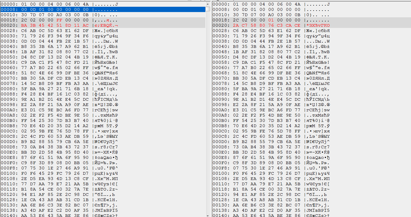

    0xFF = REGION exclusion mask (0xFF = allow all) and the 8 bytes under it are part of the re-generated hashes for the header (since we changed the header from 0x01 to 0xFF we have to fix the hashes). Further down you will see another 32 bytes changed, as well, right after the end of the contents bittable...
    Edit: The ONLY file that EVER came out from SONY with all regions flag set was the PS2 HDD MBR SONY made for the PS3 emulator to boot FFXI and Nobunaga Online. And I believe that one has 0x7F instead of 0xFF ....
