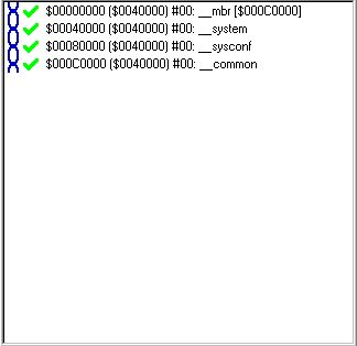

  15. l_oliveira
    l_oliveira Officer at Arms
    Nov 24, 2007
    3,879
    245
    SP193's MBR writing tool. The tool itself states that...

  20. l_oliveira
    Nov 24, 2007
    3,879
    245
    Actually, at the first sector of the harddrive you should see this:
    Offset 0 1 2 3 4 5 6 7 8 9 A B C D E F
    000000130 00 20 00 00 A2 01 00 00 00 00 00 00 00 00 00 00
    Where red is the offset in sectors where the MBR KELF is put at and how big it is, again in sectors on blue. :encouragement:
    So SONY does put it at different places, just depends on their mood at the time. PSBBN installer disc like to put the MBR at a different place than the HDD Utility disc. It's just their mood, honest. ;)
