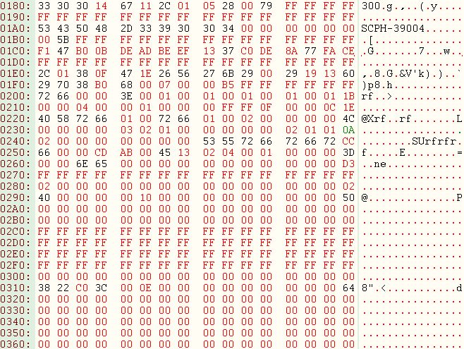

  13. fresh
    fresh Spirited Member
    Jul 15, 2012
    131
    Hehehe, congrats!
    :congratulatory:
    Okay, it was a wrong alart.
    I tested with an old hdd (30gb crap), because i have to wait for the lowlevel format of the normally used hdd.
    So, the 120gb one works with the us hdd utilities.
    :biggrin-new:
    Rgds.
    PS: My V7 looks like this.
    000001A0 53 43 50 48 2D 33 39 30 30 34 20 44 4D 53 34 XX SCPH-39004 DMS4.

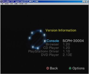

  14. krHACKen
    krHACKen Enthusiastic Member
    Oct 24, 2012
    571
    376
    Not my real one, as such HWID shouldn't pass the DNAS. I gave Zony enough MAC addresses in my vids, won't give my iLinkID. The large PSBBN 0.32 dump that has been leaked out of PSX Planet is stamped with my official HDD ID:nightmare:.
    Mwahahah, cool stuff. Is it displayed in the version info menu of OSDSYS ? I've edited this thing, with something like SUCK-D##KS and it was displayed as... "SCPH-30004":concern:. Forgot a sum or something...
  15. fresh
    Jul 15, 2012
    131
    Okay, it's 15 byte plus checksum. In this case the checksum is 00.
    Above is the correct line.
    And, yes, the osd shows this model version.
    :wink-new:
    Greets.

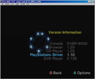

  16. krHACKen
    Oct 24, 2012
    571
    376
    Thx.
    Couldn't show it in the ver inf screen
    Maybe the DMS4 pokes something else...
  17. szczuru
    szczuru Spirited Member
    May 12, 2010
    115
    I may be off-topic but under PCSX2 it works :)
  18. l_oliveira
    l_oliveira Officer at Arms
    Nov 24, 2007
    3,879
    245
    It's plain OLD 8 bit checksum. Add ALL values then store the value on the last byte of the string.
    Dampro (of lenschanger fame) told me about this in 2005 ... lol
  19. fresh
    Jul 15, 2012
    131
    Sorry, made a mistake. The Checksum is 93 for the string.
    It's too long ago...
