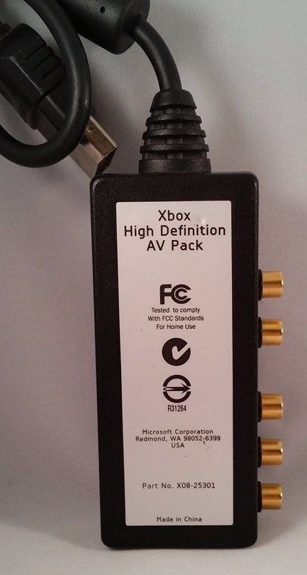

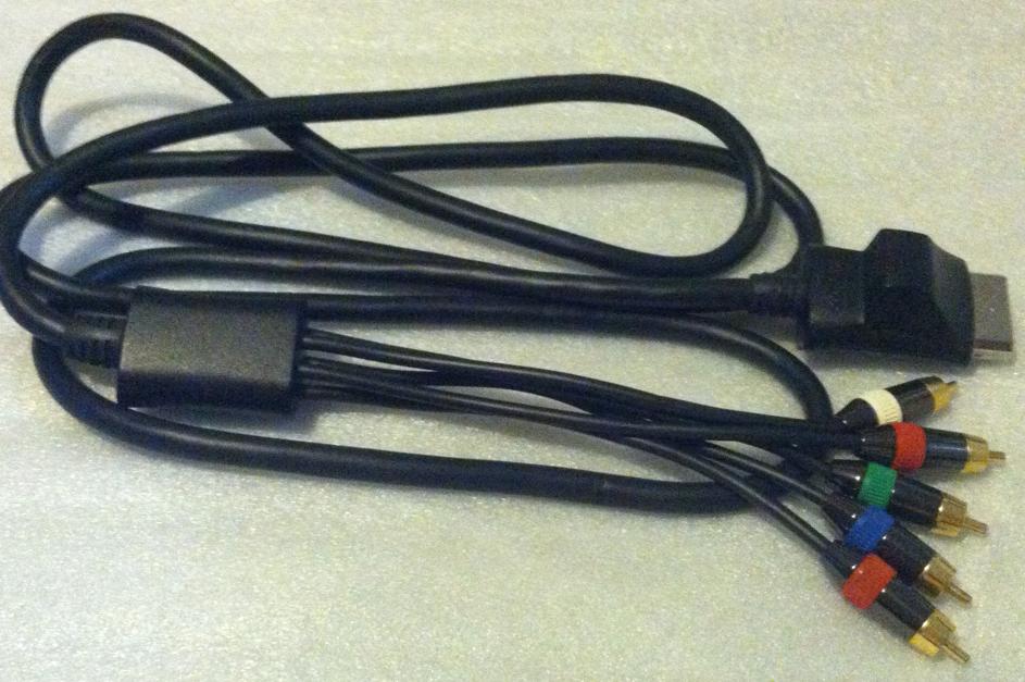

    What A/V cable is plugged into your Xbox? I see RGB cable. Which? Is it one of these?
    PAL doesn't have high-definition support until you use EnigmaH Video Switcher or softmod's NKPatcher Tools to change to NTSC video mode.
