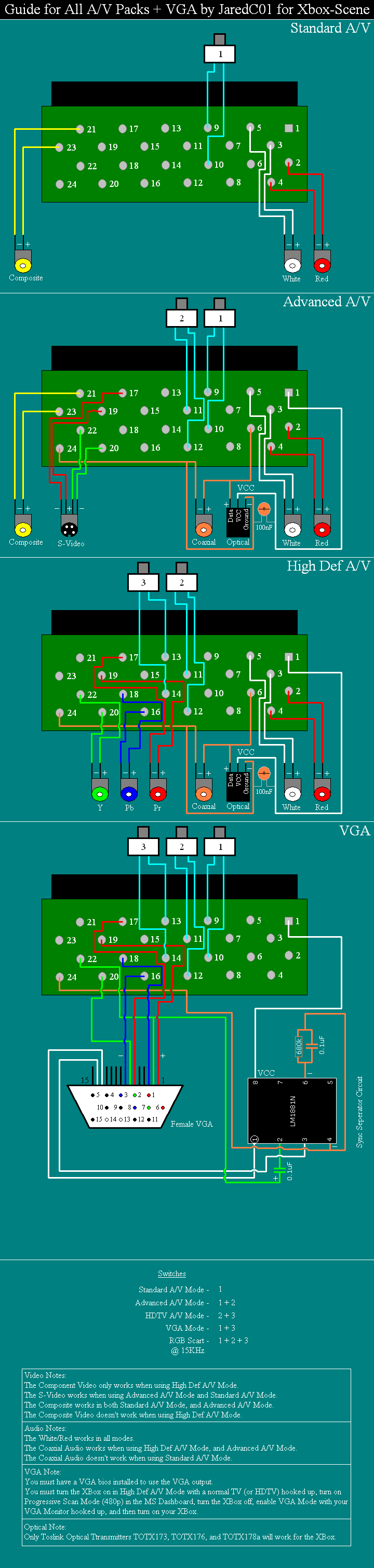

    These AVIP diagrams may help determine where there's a bad connection/misplaced wire.
    The switches in the following diagram show which of the three mode select pins are grounded for that video cable configuration.
    Check gamesx.com for another table showing the video modes selected by grounding various combinations of Mode Select 1,2 and 3 pins.
    americandad likes this.

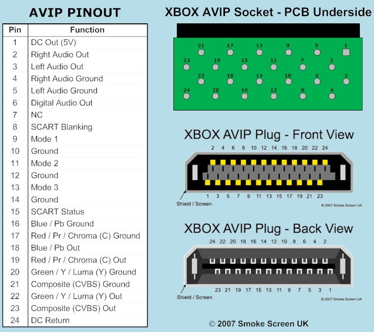

    I was thinking that the pins on the SCART side of the cable are mixed up, nott on the side of the XBOX connector. Since that RGB SCART cable has composite output in the middle of it, and composite works fine.
  11. KaosEngineer
    KaosEngineer Robust Member
    Jun 7, 2016
    224
    97
    Check the Xbox AVIP to SCART pinout at http://members.optusnet.com.au/eviltim/gamescart/gamescart.htm#xbox.
    Is there a switch on the cable?
    The composite output should only work if a different set of Mode Select 1,2,3 pins is grounded. RGB out requires all Mode Select pins to be grounded (pins 17-19). Composite either pin 17 for NTSC Stereo and pin 17 and 18 for PAL Stereo. (http://www.gamesx.com/avpinouts/xbox.htm)
    Wait I see, SCART output enabled has R, G, B and V - composite video out too.

    But, how would you place the pins wrongly in such a way that the video would have a green tint?..
  13. KaosEngineer
    Jun 7, 2016
    224
    97
    Don't think you could.
    Only GREEN tint I've seen is when VGA mode with sync-on-green was enabled in nDURE/NKPatcher via menu option for HD configuration during softmod installation.
    Maybe pin 17 isn't GROUNDED, output Y Pr Pb (Component) instead of R G B for SCART. But if so, composite video should not work as Xbox only has Y Pr Pb and no V composite signal out.
