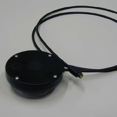

  4. spongeonfire
    spongeonfire Rapidly Rising Member
    Jul 21, 2016
    90
    47
  5. Half Mile Ride
    Half Mile Ride Rapidly Rising Member
    Nov 19, 2016
    94
    Model? Serial? Do you have any for sale?
  6. spongeonfire
    Jul 21, 2016
    90
    47
    I think its a Hitachi Cable HET01-SO01
    they are all in the original DECR-1000A boxes.

  8. Half Mile Ride
    Nov 19, 2016
    94
    Do you think that would work on DECR? For both BT & WiFi? it says it's an RF antenna.
  9. spongeonfire
    Jul 21, 2016
    90
    47
    Not sure about both Bluetooth & wifi tbh however i know these are used with the DECR

    Thanks, I'll order one.
  11. Cyberghost
    Cyberghost Peppy Member
    Feb 19, 2010
    378
    I went ahead and bought one, see if it will work. Thanks spongeonfire

  13. samspin
    samspin Member
    Mar 17, 2014
    I just acquired one of these DECR-1000A's recently from an apparent liquidation of a former developer on eBay (there were about a dozen of them, with varying degrees of quality). Mine in particular had a broken USB port, a missing eject switch for the CF card reader, a non-functional blu-ray drive and it also did not come with the antenna. Hence I got it at a high discount. But I did notice the above quoted part number for the antenna within a description on a separate eBay auction for a whole-packaged DECR-1000A (with original boxing plus foot switch and rack brackets) and on that basis decided it was worth a chance to try buying the part on eBay separately. I can confirm it fits perfectly. I dared to open the beast (it is very heavy) and discovered that the blu-ray drive ribbon cable was at a funny angle, I reseated it and now it works perfectly. So far so good. My next task in the distant future is to try and repair the broken USB port (labeled Extra) but I don't mind using a four-port USB switch and using that instead for now, it's safer than risking yanking on the remaining still-functioning USB ports (hence why I want wireless to work to minimise this risk further as it's easy to forget you're using a pad that is wired in and move too far in the room). I've just tried my luck with the antenna that arrived this morning and can confirm Bluetooth works: the PS button on my wireless pad will now turn on the unit just like a regular PS3 without having to be plugged in via USB, this didn't happen before, and it fully works wirelessly once booted. Just tried my luck with WIFI and can confirm this works too! I therefore conclude that it is worth buying the "Hitachi Cable HET01-SO01" antenna. Better hurry, there's not many left on eBay and likely they'll go fast with this news...

    My antenna arrived today and can also confirm that it works with the controller. didnt try wifi.
