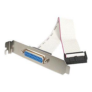

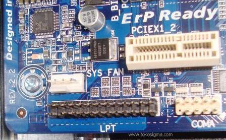

  19. Mord.Fustang
    Feb 17, 2013
    818
    182
    Assuming you have some desktops, even many modern desktops actually do have parallel ports but the headers are on the motherboard (generally labelled LPT) and the ports aren't on the back of the PC.
