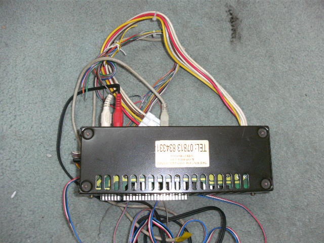

    If it's just VT3 you want to play, just use the Sega JVS-->Jamma, tons easier than using one of those. However if you want to play a driving game or a shooting game, you have to use those.
    Like this. I wouldn't use the capcom one because I don't know if it works with the lindbergh.

    The Capcom I/O works perfectly fine with the Lindbergh.

    Ok well now I know. I just heard that the Capcom I/O is hated on some Sega hardware.
