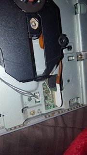

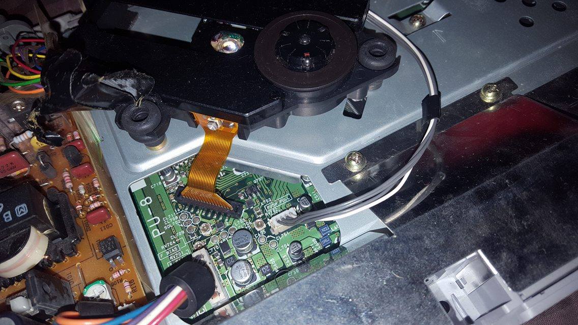

    ok guys i pick up today PS1 SCPH 1002 very nice condition but don't work he don't turn CD inside, i have another ps1 SCPH 9002 i wish to replace laser from 9002 to 1002 but shape looks different, is it same laser or ? thanks

    left picture is 1002 right picture is 9002 model
  4. TriMesh
    Jul 3, 2008
    2,324
    It's electrically compatible, although you will need to fold up the longer flex PCB on the KSM440-AEM to get it to fit. You will also need to modify the plastic frame to get the cover on, because the AEM has longer plastic pegs on the lower side.
