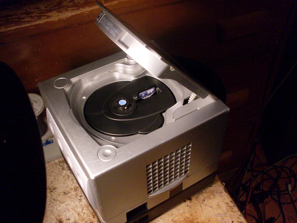

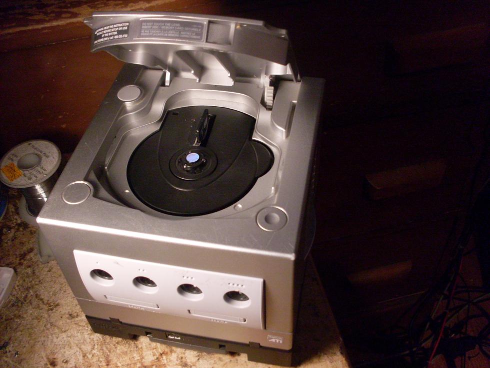

    I decided to do a little gamecube modding. I bought myself a wiikey fusion so I can run game isos from a sd card since I hate optical drives. For those who don't know the wiikey fusion is a modchip for the wii but it can be wired into a gamecube as well. The downside to the wiikey fusion is that it's a "solderless" chip, meaning it connects to the wii by a tiny ffc ribbon cable using no soldering.

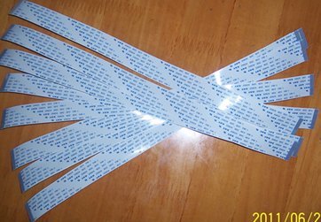

    With the gamecube you need to solder the wiikey in yourself. Soldering to the gamecube isn't a problem the solder spots for the dvd drive are through hole so they're big enough. The problem is the wiikey pcb only having connectors for teeny ribbon cables. I should have ordered a ribbon to dip adapter breakout board but an internet guide I stupidly followed made it look like soldering to the ribbon cable is easy enough to do. My ribbon cable soldering worked for a bit, then failed when moved around because ribbons are weak and easy to break. My solution was probably the dumbest thing I've ever attempted:
    I removed the ribbon connector with a heatgun and hand soldered wires to the asic connections. In some spots this lifted the pads and made me scrape masking off the trace so I could solder to the trace instead. Surprisingly, it works perfectly.....for a while, then it died when I moved it around again. I redid the solder work, that mostly fixed it, then I redid it again and now everything works perfectly.
    Glued nicely into place (and smoothed the glue with a heatgun):
    It's alliiivvvveeee
    I took the dvd drive cover off temprarily while I give this thing some serious play testing before I decide where to install the sd card slot and the switch needed for the wiikey to activate.
    The 15-20$ ribbon to dip adapter board is well worth saving the pain of doing it this way.
