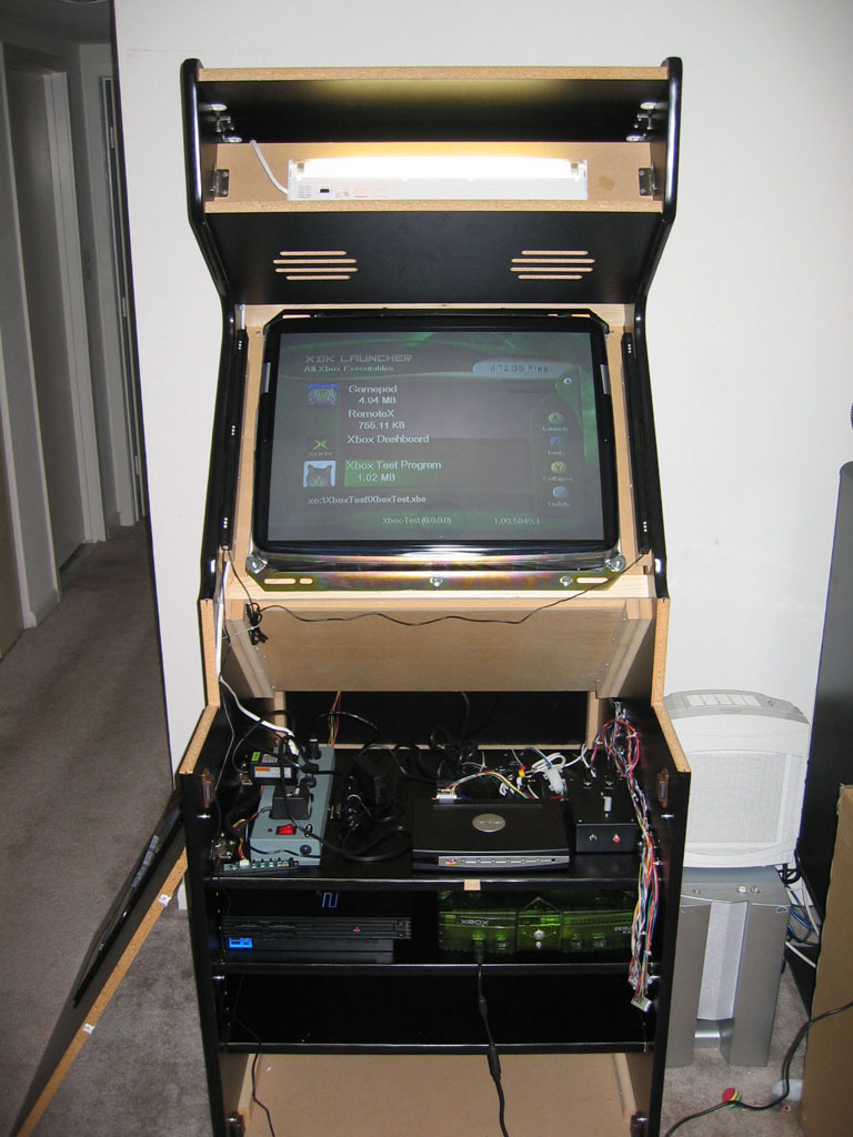

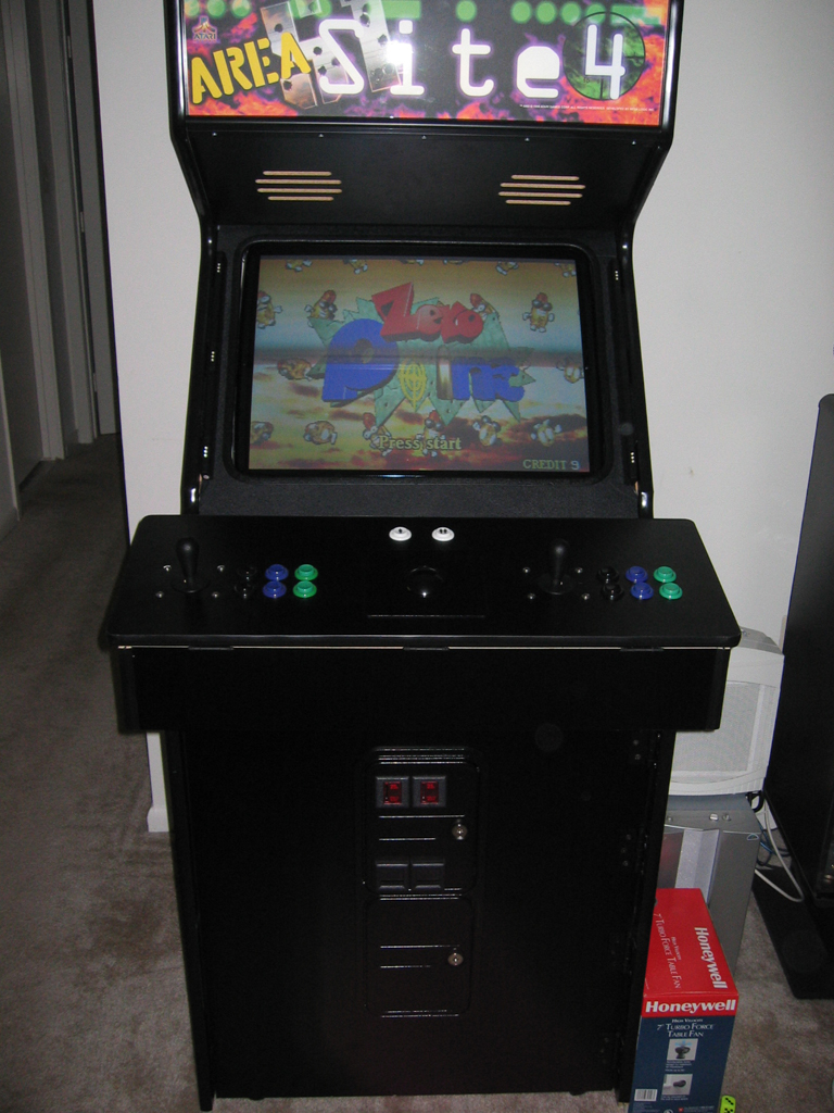

    Well, I finally got my cabinet kit (only took about four weeks for the guy to ship it) and finished getting it together. Still waiting on the control panel, marquee plexiglas and retainer to arrive. Anyway, here are some pictures:

    Bad allegies + no power tools + lack of building skills = no project cabs. I wanted a cab that would last years and be able to be dual JAMMA and non-JAMMA capable.
    Here's the price breakdown from what I remember (redone):
    Billabs 15-48KHz 27" Monitor ($550 + $150 shipping): http://www.billabs.com/bl27cb0p.htm
    Arcadeshopper Cabinet Kit ($400 + $250 shipping): http://www.arcadeshopper.com/store/product_info.php?products_id=28
    Over/under Coin Door ($50 + $15 shipping)
    MameRoom Custom Control Panel ($125 + $30 shipping): http://www.mameroom.com/uacontrolpanel_info2.asp
    Marquee Retainers ($10)
    Marquee Plexiglas ($20)
    Bob Roberts JAMMA harness, wiring and other internals ($153)
    Incidentals ($200)

    What type of monitor is it, and what will you use for controllers? Will you install an arcade stick panel?

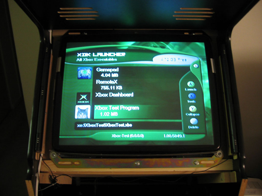

    I added more info to the components listed above. The monitor handles all the regular arcade resolutions (15/24/31 KHz) and goes all the way up to 1024 x 768 through the VGA connector.

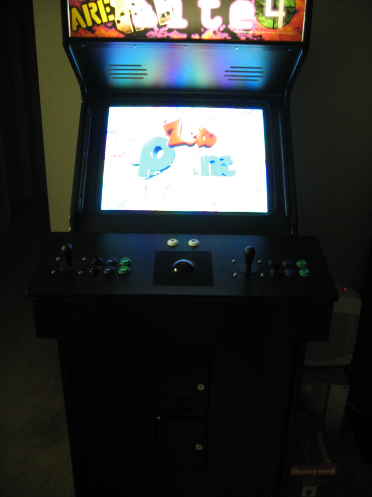

    Definitely putting in a real arcade panel. Going with a combination 2 player, six button setup with a 3" trackball. Also throwing in a nice pair of Happs Lightguns for the arcade games and one of the LED Lightguns for the PS2/Xbox (you can see the LED stands on the side of the monitor).

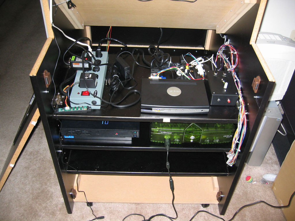

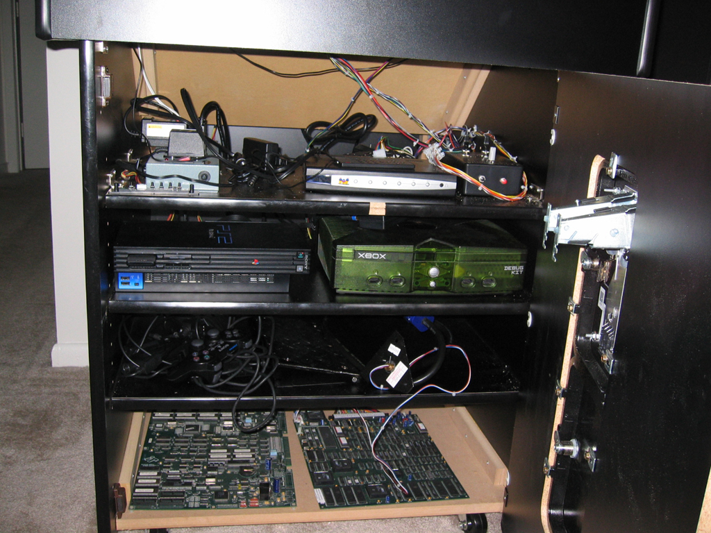

    The cabinet also has a full JAMMA harness in it, so any of my arcade boards can be put in (mainly lightgun or trackball games). I also plan to throw an old laptop in there for MAME/emus. I am tempted to throw the extra Gamecube I have in there just for Ikaruga.
    Since the monitor handles up to 1024x768 resolution natively, I don't have to get an ArcadeVGA card, though I do already have a JPAC for the controls. :nod:

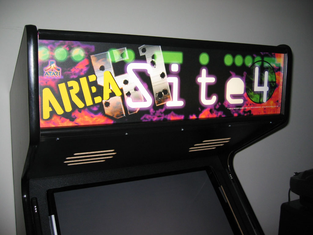

    (updated pics above to include newly finished marquee)

    Finally got the control panel. Will put up pictures sometime tomorrow I hope.

    Actually, you'd want the ArcadeVGA for low res displays, not high res. You say it handles 15khz signals, right? Forget the laptop, and buy a cheapy PC for like $1k or something, and throw the ArcadeVGA in there. You get native 15khz signals for MAME games. If it handles VGA though, you can put fake scanlines up that will simulate 15khz nicely. I have a 15khz only monitor for basically everything that's not 31khz compatible (DC/Xbox). Scanlines don't work in this case.

    I was just going to use the fake scanlines for MAME and Nebula, or play around with Powerstrip since I don't have to worry about exact snycing with this monitor. I agree that the native resolution looks the best, but I am not a purest when it comes to non-lightgun games. For those, I try to get the actual arcade boards.

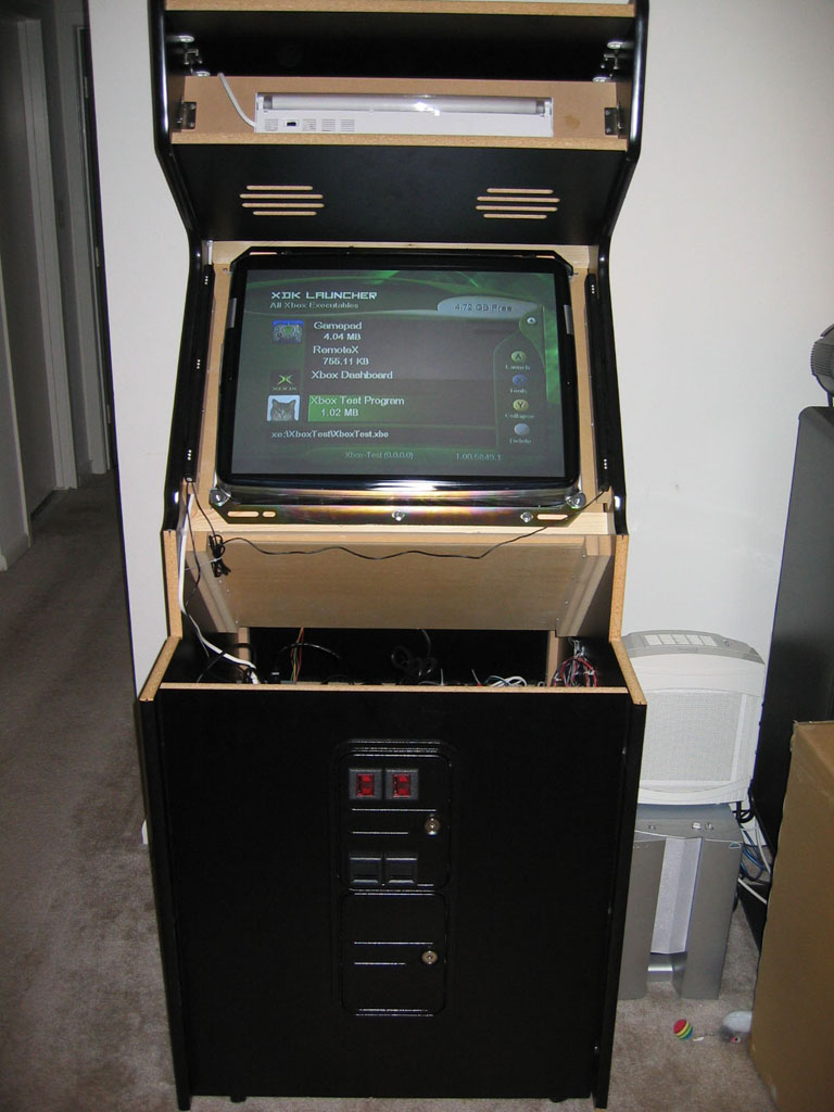

    Yes, you are right that you would normally need a sync hack since the consoles generally output at 31KHz and the majority of arcade monitors run at 15KHz. However, that is technically a JAMMA spec for "high" resolution. This monitor syncs anywhere (and I do mean anywhere) between 15 and 48 KHz.
    Heh, been meaning to do that for a while now... First picture was taken mid-scan; the monitor doesn't have a line going through the middle of the screen. The front panel is hinged (using the coin return slots as a handle) so that it is easy to get into the guts, but when it is closed, the machine looks like a regular arcade machine.
    I still need to permanently install the pair of Happ lightguns and see if I can fit in the LCD guns (one PS2/Xbox and two for an incoming Lost World kit).
