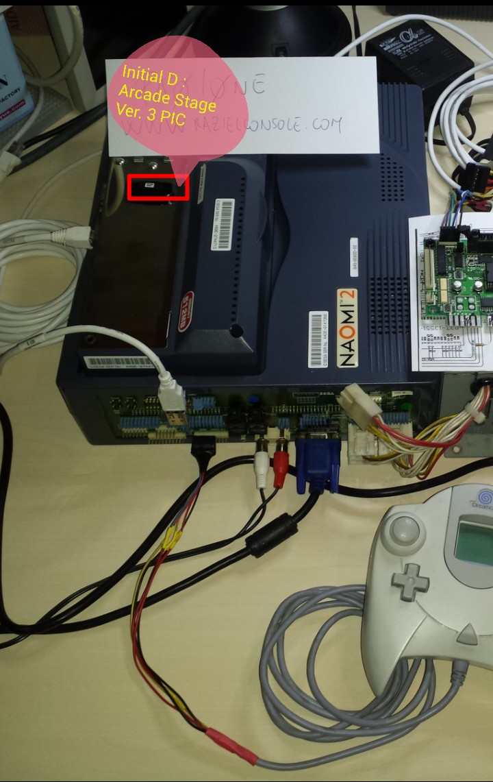

    Yes, it's true..but only if you use a permanent connection with the PC (Or the Raspberry with NaoPI) and the python script. It permanently inject code (about ever 5 sec.) that inhibits the need of the pic key.
    Against if you use the regular SEGA "transfer.exe" you need a (zero) pic key installed on your Sega Naomi.
    This is my Naomi setup with an original Virtua Striker programmed Security PIC that netboot all games with phython script and multibios installed on it.

    thx:) But I have only Initial D : Arcade Stage Ver. 3 programmed Security PIC
    Can I use Naomi setup with an original Initial D : Arcade Stage Ver. 3 programmed Security PIC that netboot all games with phython script and multibios installed on it?
    Like this?

    Yes indeed you can!
