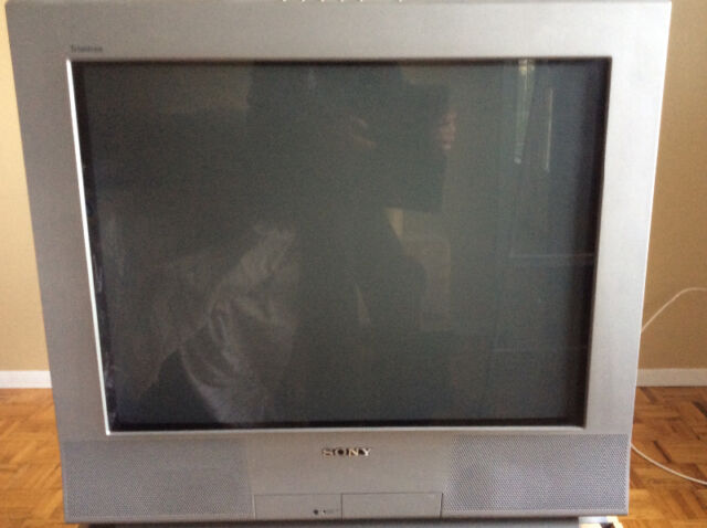

    Well, I'm in the market for a CRT for my older consoles. I kind of had Sony Trinitron on the mind. I found this in the area for free:
    Are these decent TV's? Or should I hold off for something else?

    The model number is on the other side of the TV :x

    Lol, this is just the picture from the ad, I don't have a model number. It's 27" if that helps, ha. I was hoping someone would recognize this era of trinitron and have some experience with them.

    id say its decent. i use to have one like it dedicated for HALO 2 and OOT

    There good for ps2, gc and xbox. Everything else their a hit and miss with retro systems especially light gun games. Best option would be to get an older trintron with at least s-video.

    ah i see where this wrong information about flat crts comes from: some people seem to think that all flat crts are 100/120hz, which is not true. yes theres problems with lightguns on 100hz tvs, but this has absolutely nothing to do with the flat crt.
    on a 50/60hz flat crt all lightgun games work same as on a curved screen!

    Why not ask the seller? Better yet instead of going thru Ebay and pay extra for shipping, hit Craigslist. You can test the TV locally with a PlugNPlay portable game. The picture indicates a smaller older Trintron flat tube TV.. These all are SD tubes.
    The last of the generations of Sony Flat CRTs had the speakers on the side. And yes Lightguns do work if an SD Tube; both curved and flat CRTs.
    I have a preference on the HD WEGA CRTs. You lose lightgun support, but gain in the additional resolutions of 480i-480p-720p-1070i all with NO upscale issues.
