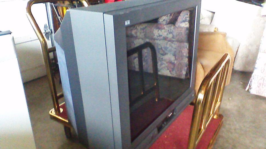

  11. speedyink
    speedyink Site Supporter 2016
    Apr 10, 2015
    1,409
    584
    So I ended up with this for now. Will keep my eyes out for a better one
    Component? Toshiba, who are you kidding, lol. No way this tube will do it justice.

  17. Eviltaco64
    Eviltaco64 or your money back
    Jul 16, 2008
    1,027
    136
    A bit late to the punch here.
    It will not play light gun games, but you lucked out in many ways!
    The 34XS955 sports a Super Fine Pitch tube. That technology was one of Sony's very last innovations in CRT technology. I believe there were only 3 high-end Trinitron sets that employed the tech (the other two sets are the KD-XBR910 & KD-XBR960). The widescreen XBR models are still somewhat of a sought after collector's item for home theater enthusiasts.
    All of these sets came out near the very end of the Trinitron's life, somewhere between 2004 and 2006. The 4:3 set you got is the odd one out, but it's still a damn good one. The picture quality that these TVs were capable of producing is arguably among the the very best you can get out of a CRT set.
    Something great about HD CRTs is that they have no native resolution - they run every resolution natively. It makes them quite versatile. Since the set you are getting has at least one HDMI port (very uncommon for a CRT, mind you), it will do PS4 and N64 with an equal amount of justice.
    Since SFPTs are rather sensitive, a lot of sets may require a little calibration and geometry adjustment to really fire on all cylinders.
    speedyink likes this.
  18. speedyink
    Apr 10, 2015
    1,409
    584
    Well, as I have no light guns I can live without that for now. Maybe I should keep the little shitty TV I got for such things. Also, this one is 16:9.
    I'm very happy with this TV so far. I like how it upconverts SD signals to HD. The only downside to this upconversion is it doesn't play nicely with NES and SNES. Those two systems apparently run at a non standard frame rate (like 0.02 FPS off or something stupid), and it trips up the system, causing slight screen tearing.
    Honestly though, while the screen isn't tearing the systems look amazing on this TV, enough that I'll deal for now. Every other system I've tried looks amazing. Was playing some PS2 before bed the other night (using component cables) and was just in awe at how...natural everything looked. I want to plug my PS3 into the HDMI soon, play some games, watch a blueray. Really happy with the purchase. Can't believe the sound it puts out too, with a built in sub, I don't have to turn on the stereo very often.
    Also happened to get the matching stand, remote and manual, he had the box too but it was huge and I have no where to store it. Not bad for $75 cdn, especially since he threw in a Sony Discman (d-EJ1000) in box with all accessories.
