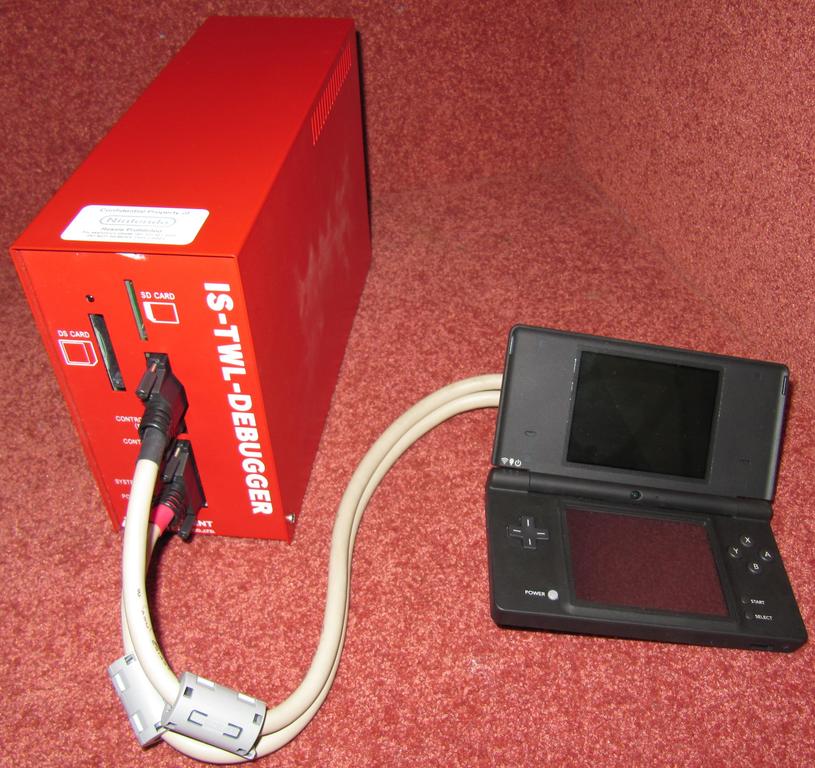

    Few month ago i've got this dev hardware, in fact i've got 2 box : one IS-TWL-CAPTURE and one IS-TWL-DEBUGGER. How using it? What is it exactly? Some specific software needed?
    I didn't got the power adapter, easy to make one?

    You can use the AC adapter of a Wii.

    Thank you for all indication, but i've got other quaestions:
    -Is the piece of hardware easy to get, in common world?
    -Is many people got it?
    -Is Nintendo touchy about non-dev getting this things?
    -Where can i get the SDK (dl 3Go isn't a problem)?
    -What's the diffrence of CAPTURE and DEBUGGER?
  8. hl718
    hl718 Site Soldier
    Nov 19, 2004
    2,856
    Capture is for video out.
    Debugging is for doing actual debugging work on a program you've developed.
  9. sonicdude10
    Jan 17, 2012
    2,573
    To answer in order:
    No it isn't. Very hard and expensive.
    Not very common so not very many have one. Mostly dev guys and some game reviewers.
    I have never heard of Nintendo getting pissy over general public having dev stuff for outdated consoles. If it was for 3DS they might but even having dev stuff for current generation hasn't had a problem I've heard of.
    Not sure.
    As hl718 said, CAPTURE has video out for regular screens, DEBUGGER is for debugging work like viewing the system RAM real time and such.

    Viewing the ram in real time, i think there is a freeze function too. I remember the great time of WinIce for debugging purpose on windows, i hated my job, i don't like so much ASM...
    However this function could very interested for making non-authorised copy of games... There is a SD-card slot, what's its function?
    It seems that there is two videos connectors on each box, with non standard connector (N64 video connector?), how can i make quality record with that?

    The 2 video connectors are the same as the connector on the SNES, N64, GC, etc. and one is for top screen and the other is for bottom screen.

    The SD card slot is there because you have the version based off the DSi. It has SD slot for video recordings and such. It might serve a few other purposes since this is dev stuff but I wouldn't know. I just know it's the because this is basically a DSi with high end video upscalers and a few other bits for dev use. Standard DSi uses the SD card to store games downloaded from the Nintendo store, store the recordings from cameras, and save a few other bits as well.

    Looks like it uses the Wii's power brick and AV out this time?

    This nice little beast is NITRO-compatible too, there is a legacy mode to do this.
    You can test NITRO builds under ensata on the TWL.
    And beside many new things compared to the NITRO (and the DS, like camera & SD card, etc) she has more memory, new DMA, new WRAM, a DSP, new mem map, a new version of wireless module and AES en/decrypt support.
