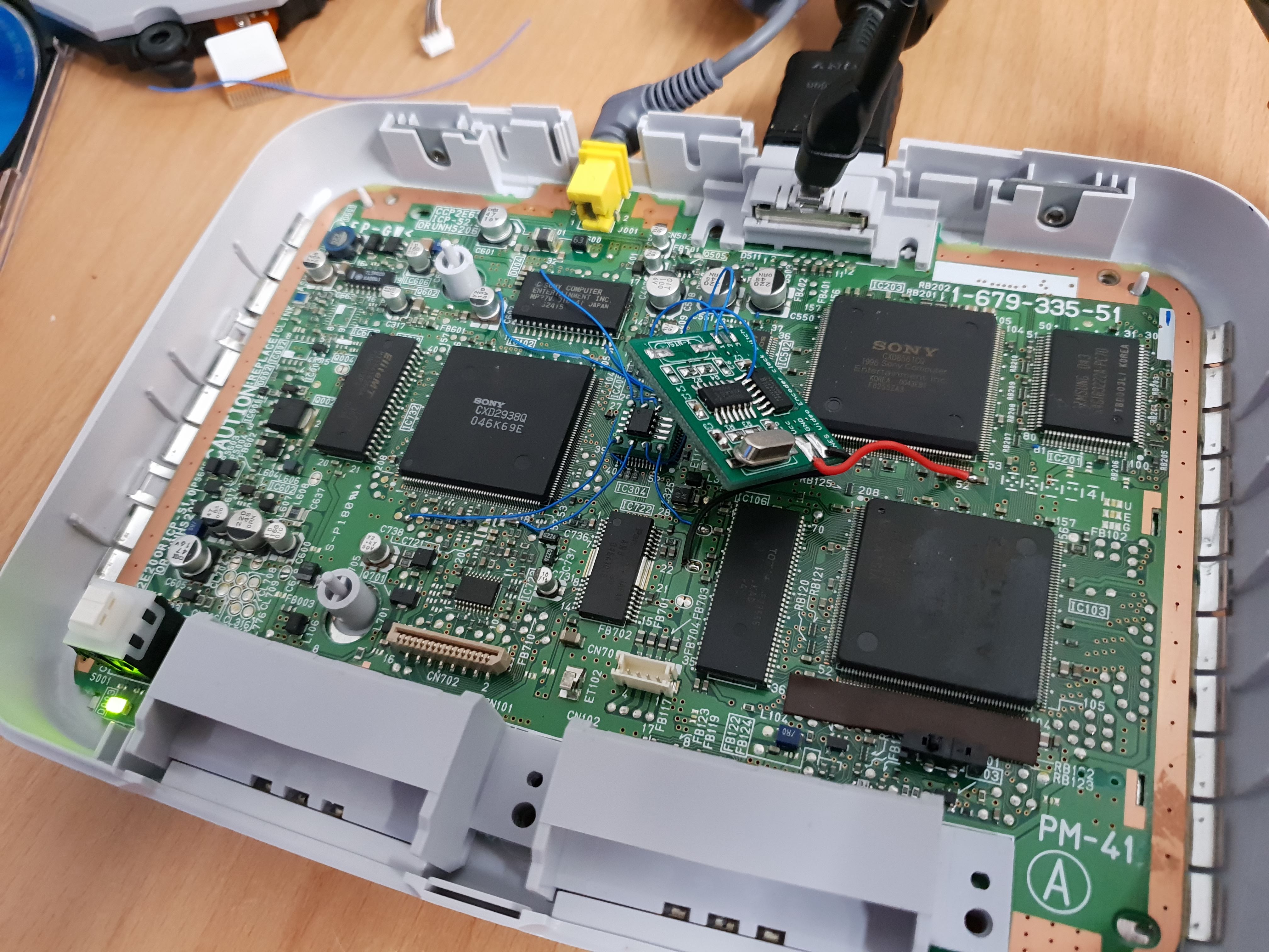

    Sorry for the necrobump.
    The black&white issue applies to me with a SCPH-102 onechip so I was wondering if we can mod the video output to a correct 3.58MHz NTSC/4.43MHz PAL one. For super famicoms I often install a little video clock switch board which depending on the mode NTSC or PAL feeds the clock signal into the S-PPU2 to achieve a color image on most any TV. This works very well even though I use 2 crystals instead of deriving the clock from the actual console's internal clock which theoretically could result in some synch issues I believe.
    My questions is whether a similar mod is viable for the PSone.
  8. zzattack
    zzattack Spirited Member
    Nov 19, 2014
    161
    62

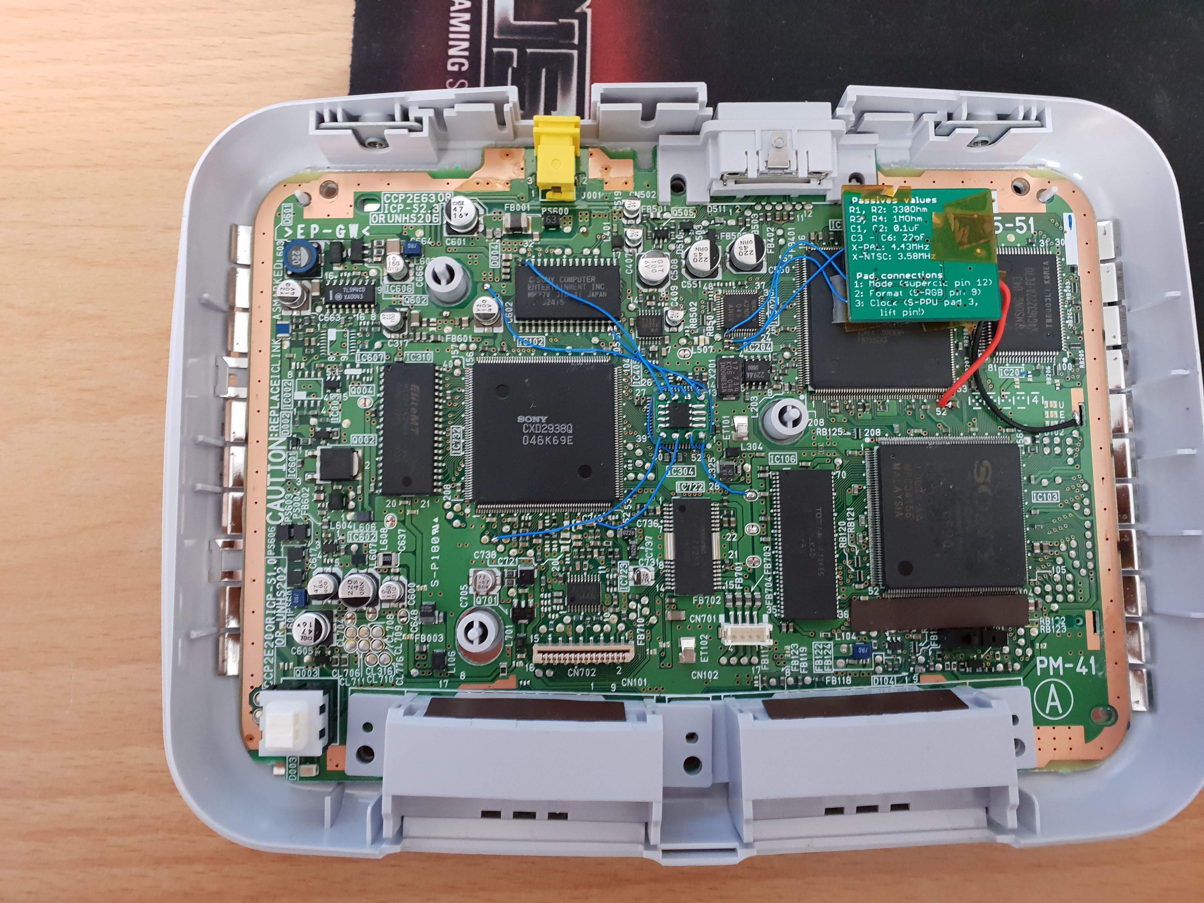

    Figured this couldn't be too difficult so I just had a shot at it.
    The SNES PPU 50/60Hz pin vs PSone video encoder mode pin were inverted so I had to swap the 4.43 and 3.58MHz crystal locations and figured I might as well grab the 4.43 that's already there instead of wasting a crystal on it.
    What I did was remove the resistor that connects the main clock derived 4.43MHz and the video encoder chip subcarrier input pin 15. Used the output selector method pin 13 to switch between the 4.43MHz and 3.58MHz boosted by a 7404 inverter. Finding a decent install spot wasn't entirely clear due to the height of the crystal. Mounting it upside-down made soldering somewhat interesting but allowed for the RF shield to be installed without pressing on it.
    Oh, before I forget to mention, now I get color for both PAL and NTSC games, so mission accomplished.
