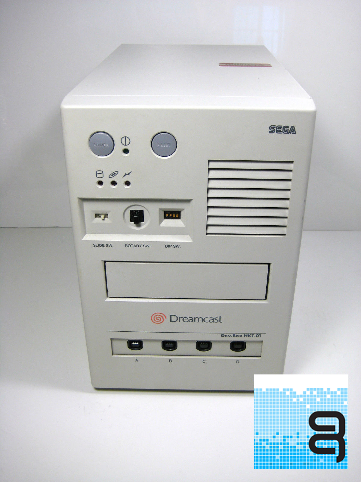

    Hey, my name is Darryl. I'm from gaikokugamers.com. Me and a Canadian friend of mine do a gaming podcast every week. I've been a huge fan of Sega since the early 3D era arcade machines started to show up (still remember the first time I played Virtua Fighter 1, oh dear god it was amazing!). ANYwho, I recently got purchased a Sega Katana in really nice shape. I've wanted one of these for many, many years and picked it up for a low price.

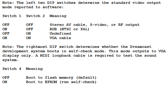

    The unit is in great shape and powers on. The seller said he couldn't get picture on a monitor, but judging based on his lack of general gaming knowledge, I think it's simply that the dip and slider switches were in the wrong positions. I know that all the dipswitches need to be down and the rotary dial to 4 to switch it to US. And I know that I might also need to set the 1, 2, and 4 dip switches up with the rotary set to 0 with the slide switch to the right while holding reset which might fix any video issues as well (switching it from emulation mode, right?).
    Anywho, the unit isn't in yet (comes next week), but I'm just trying to gain any dip switch settings I can learn while I wait so I have different things to try once it comes in. Like I said, it powers on, and his dip switch settings seemed wrong to me (which would explain the lack of picture), but you never know and I want to be as prepared as possible.
    I'll post more pictures and let you know not only if your solutions get picture up, but also what exactly is on the Katana once it comes in. Until then, here's a pic of the dev kit:

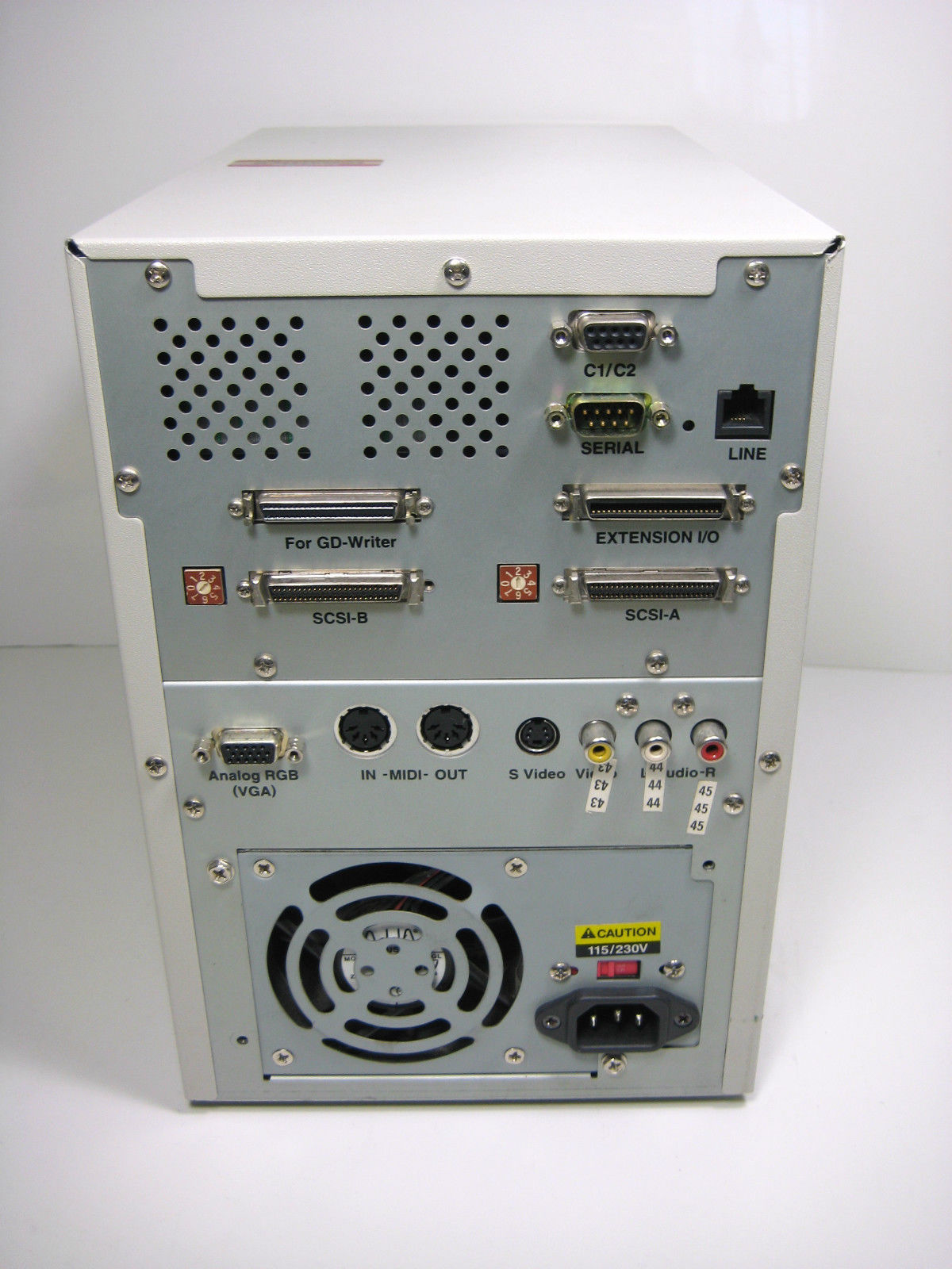

    Cleaner than mine! Looks to be a set 5.24, so you'll need sdk r8, r9, r10, or r11b if you're going to set it up with a computer. And an scsi card, an scsi cable, and some 50-pin scsi active terminators (I use two). There's a stickied thread that goes into much more detail about that process though. http://www.assemblergames.com/forum...v-Setup-(Inc-Setting-up-an-HKT-01)-(08-05-07)
    Taken from getstart.txt, included in the sdk. http://dreamplace.zzl.org/text/GETTING STARTED WITH DREAMCAST R10 AND MASTERING A GD-ROM.html

    Remember to make a block for block image of the disk before starting to muck around with it. That way you can possibly restore deleted files on it in peace and quiet at a later date. At the minimum grab everthing on explorer and archive it somewhere. If you don't have or plan to get the PC and SCSI-interface needed for that then consider unscrewing the HDD and handing it to someone else for dumping.
    You will be able to play GD-ROM based games of any region. But that is honestly just a more expensive and unwieldy way of doing something you can already do with your normal DC. To configure the emulation parameters for running games from the HDD you need to connect it to a PC.
    You could also play GD-Rs if you have any of those laying around.

    I use Windows 7 with my Katana, there is an aspi replacement stickied in this section too I believe.
