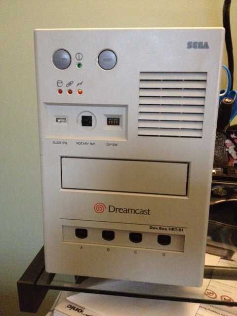

    Ok, I need some help. Trying dip switches in different settings, the katana is on... can't get a picture. Any specific instructions I should take to troubleshoot? I'm trying via RCA and VGA. Can't seem to get an image.
    No, I don't have a PC to plug it into at this point. Thanks in advance
  3. ceramicsaturn
    ceramicsaturn Member
    Jan 17, 2014
    I've tried 1,2, 4 Left Slider 0 rotary, all dips off left slider 4 rotary...
    Can't seem to get anything. Any ideas?
    I put in a game, and it was spinning it before I took it out. So it's working... ish. Just can't get a feed on either VGA monitor or AV cables.

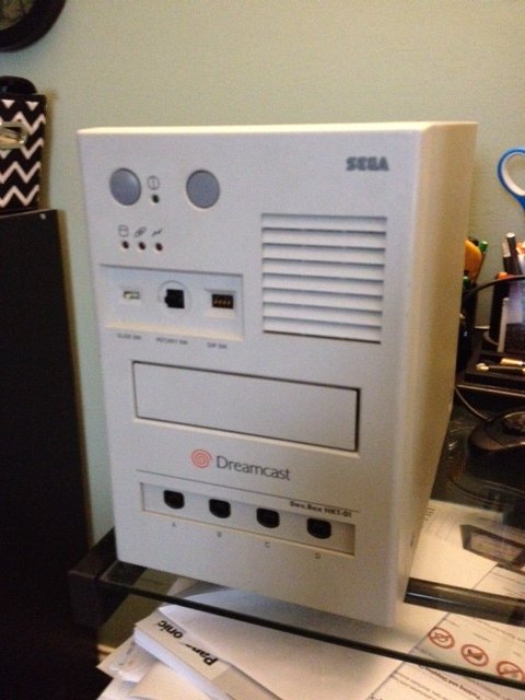

    While I wait for some ideas, here are some pictures:

    - Rotary on 0
    - Dipswitches (from left to right) for VGA output: UP, UP, DOWN, DOWN
    If you have no screen visible via the VGA after that, the devkit is probably in dev mode.
    There are two modes:
    - CPU mode = dev mode = the devkit will boot on a black screen & wait for you to upload a program via the SCSI cable
    - OS mode = Bios mode = the devkit will boot with the usual katana logo, dreamcast bios & co. It will aslo play a sound when showing the katana logo
    To switch modes, just launch Utl\Dev\DACheck\DAcheck.exe, and exit immediately without doing anything.
    The program will ask you to select a mode to reboot into.
  6. ceramicsaturn
    Jan 17, 2014
    Ok, no image when doing that, so I guess it's in dev mode. Crap. I don't have a PC around here atm to run the exe. Guess I need to hunt down an old PC and start setting that up. :-/
