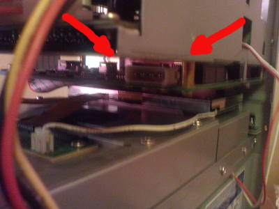

    This is what I've done so far:
    I picked the Katana apart to get a basic feel for it and fixed two things on the way:
    * A bent connector on the modem board that was dangerously close to shorting out. Might have been shorted at some point, but shouldn't have damaged anything important.
    * One of the flat connectors to the GD-ROM was in a skewed and in a position where it shorted several pads.
    Then I took a look at the formerly broken front panel that Parris have had fixed. I can find no fault with it. Whoever fixed it did a good job of it.
    Firing it up led to the aforementioned three lit orange diodes on the front. Also noticed that the seemed to be very dim compared to all the other diodes in the case.
    Then I fitted it with two active terminators(1) and attached it to an old PC fitted with an Adaptec AHA-2940UW with a wide-to-narrow cable. My somewhat far fetched hope was that the terminators would make a difference in detecting the two SCSI devices that Parris never saw. Unfortunately the card did not report any devices at boot, and if the card doesn't see them at boot no amount of fiddling with drivers will make it work.
    So now I was going to have to debug the entire SCSI-chain in the Katana. Fortunately I started by tracing all the power connectors, and that very quickly came upon this:
    Attaching the missing molex to that made the machine much happier. It cycled through several patterns with the front panel diodes (now at full power) and looked and sounded much healthier. It still doesn't output anything when booting. Neither video, nor sound. But it does show up as two SCSI devices, and the test program on the PC managed to read out the versions of the two devices flash. It did not pass any of the tests in the same test program though.
    Today I'm going to read up on reflashing and give that a go. Any tips on how it's done gladly accepted.

  5. Mark30001
    Mark30001 Guest
    Well DUHHH! No wonder it wasn't being recognized, as the Emulation board wasn't receiving any power!
    Yeah, it most likely works now. You'll have to open DACheck and set it to (either CPU or OS mode... the opposite of what it currently is) so that the Dev.Box will actually boot to the screen with audio/video when you power it up.
    It's pretty much self explanatory once you load the Katana SDK disc, or you can run DB-Flash. Just remember to set the SLIDE SW switch on the front to the right, reflash, set to back to the left, then turn off your unit for at least 30 secs (sometimes a little longer since they're so old).
    You'll know that it successfully reflashed when you see the Dreamcast logo on your screen.
