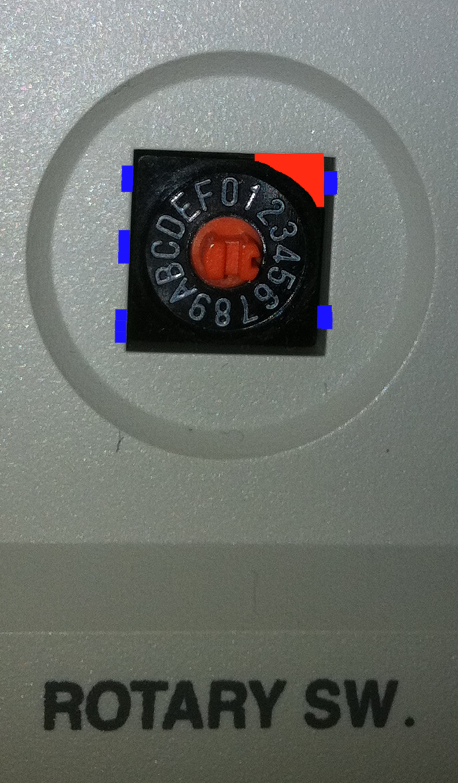

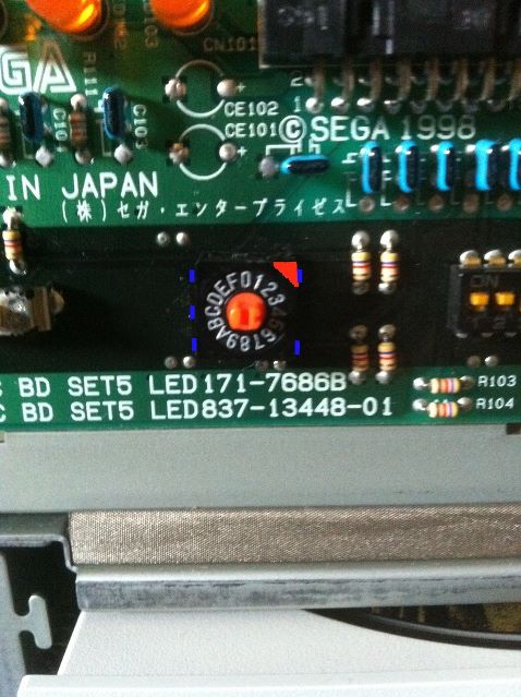

    Hello
    I have the same problem the switch broke during transport :sorrow:
    this switch is really compatible???
    The sense numbering is not aligned to the pin of the original:dejection:
    http://www.farnell.com/datasheets/28986.pdf
  20. chacal
    chacal Member
    Feb 21, 2007
    it is good it is repaired
    I cut the base of the plastic switch pin & weld wire:encouragement:
