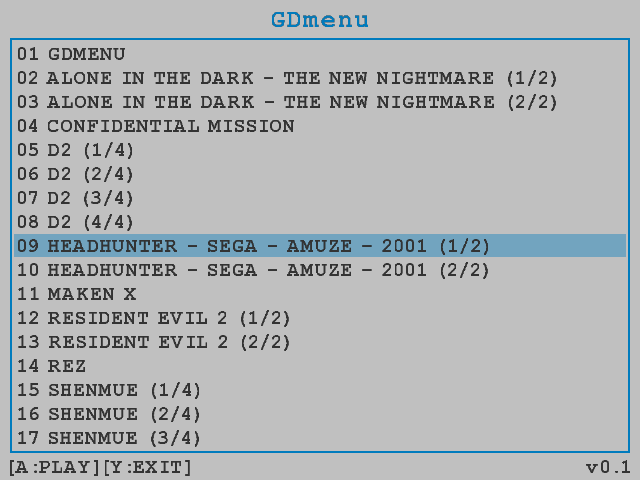

    GDmenu v0.1
    Hi, there
    Here's the new version of the GDmenu!
    Download
    GDmenu_v0.2(15-09-2014).zip
    This version requires the new firmware 5.7.0 for the GDEMU.
    Download it and follow the instructions on http://gdemu.wordpress.com/firmware/ to install.
    The GDmenu now generates the list of games on the SD card before loading the UI
    and supports the Up/Down buttons on the D-pad to navigate the game list, instead of using the tactile switch.
    The navigation is way faster, which improves the experience a lot.
    The UI has been improved, by using a different font and better rendering method.
    There's also initial support to load the games list from a file so it allows customization of the names and no loading time.
    Making the list/image will be either integrated in madsheep's app or I'll create a simple app to do just that.
    The VMU save/load function was removed, so if you have a save on your vmu from the GDmenu, you can go ahead and delete it.

    I've run into a problem. GDMENU freezes on the loading screen (with two dots at the end).
    Any idea what i'm doing wrong? I've updated the firmware to 5.6.0.

    Mine freezes just after that - on a black screen, but if I keep folder 01 blank and put the menu in folder 02 - and then run it from the dreamcast dash all works fine. Very impressive :)

    Same here, if 01 folder is used for GDMenu then it freezes. If used 02 it works but displays wrong folder numbers, like if 02 was the first and 01 was the last (empty).

    Neuroacid, can you tell more about the game list file and how to create one?

    It's really weird when you test something a ton of times, accounting for many difference scenarios and don't find any problems
    but then when you release it every one seems to have problems :)
    I guess I'll go ahead and just remove the link for now, while I figure why it only seems to work with my GDEMU and DC.
    rebuild the disc image with a list.ini in the root with the following format:
    [GDMENU]
    01.name=GDMENU
    01.disc=1/1
    02.name=ALONE IN THE DARK - THE NEW NIGHTMARE
    02.disc=1/2
    03.name=ALONE IN THE DARK - THE NEW NIGHTMARE
    03.disc=2/2
  11. LordFenixNC
