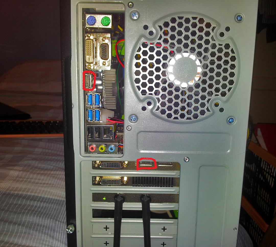

    I would like to know that if it possible to record PS3 gameplay from the PC instead ? because there couple PS3 proto I need to record.
    Here the picture of my custom build PC and Spec are powerful enough to recording PC games with FRAPS lag free.
    Specs are
    Gainward Nvidia GTX Geforce 680 graphic card
    I5 core CPU
    As you can see there two HDMI Imput as marked in red circle. One HDMI on the motherboard and second HDMI on Graphic card.
    So I wonder is it possible that HDMI conntected from PS3 console to PC Hardware which would display on the monitor and record it with The FRAP sofware during the gameplay ?
    Or any software to do that so ?
    Thanks.

    I don't know but I aways had the impression that HDMI ports on general consumer devices are output only.
    Exactly for the purpose of preventing people of doing exactly what you're trying to do...

    Those are all outputs, sorry. You need additional hardware to capture.

    It depends on if you want a USB one or if you have an internal PCI-e slot. I use the Blackmagic Intensity Pro, since it has HDMI slots

    It's not but HDMI point is making it hard to copy HD content such as Video from consumer discs. That's the real reason these ports exist.

    Well really, HDCP is the main culprit in that hah. Luckily, with all the codes out there HDCP has become less of an issue. Even now, I was able to strip the HDCP part out for 50$ or so, now I can capture PS3 unhindered without a debug kit

    HDMI traffic is encrypted.. MPAA and others insisted. It's a hack, but you can connect a component cable (analogue) from your PS3 to a TV and DVD recorder, record the gameplay then rip the files from the disc with your PC.... Just a thought.

    My final decision is getting
