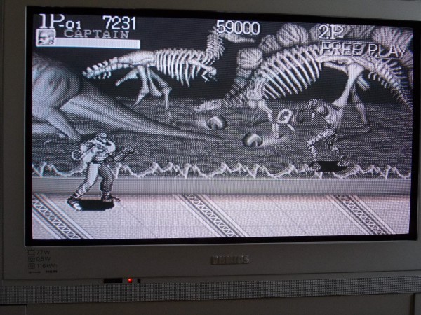

    When connecting the modded PS1 and running a backup (NTSC-J), I get a black and white image, with both RCA or SCART leads.

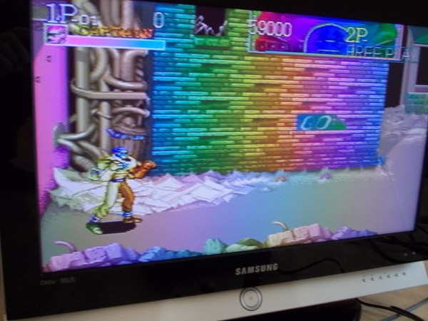

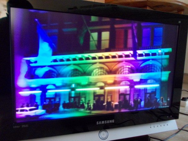

    I also had a try with a Samsung TV set and this time i had color... but it's like a rainbow effect on the image !
    Same result with an original game (NTSC-U/C), the picture was taken during the beginning of 'Parasite Eve'...
    I think all this is a little bit messy, don't you ?

    All 3 of those images are running in composite mode. So either your SCART cable doesn't have RGB support, it's plugged into an input that doesn't support RGB or you need to manually switch over to RGB.
    The images with the strange color are what you get when your console is outputting NTSC-4.43 and the TV tries to decode it as PAL-60. If you have a SCPH-7502 or a SCPH-9002, there is a simple mod (cut a trace and add a wire) you can do that should fix that. There are fixes for the older consoles, too - but they tend to be more complicated.

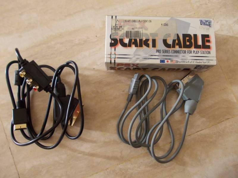

    First, using the 5502 PS1 + modchip, I had to find the right lead to connect the console and the TV set. The official Sony lead didn't showed me anything else than the rainbow picture mentioned above.
    I also tried with another lead (SCART gold plated, on the left), same thing. I finally found a RGB SCART lead that works (on the right, please note that the box clearly states that it works for EUR, JAP and US).

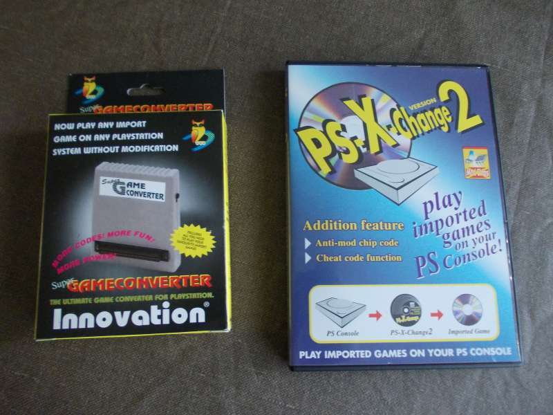

    First, I used a 'super game converter' cartridge. As far as I understood, this should works for both PAL and NTSC consoles. Plug the cartridge onto the parallel port and put the spring in its place, insert any game from your region and start the PS1. After a short moment, the disc stop spinning, then you can replace it with the imported game without any risk, and play.
    In a second time, I used a 'PS-X-Change 2' tool which is about to be the same thing. Just insert the PS-X-Change disc (spring also needed), start the PS1 and wait until it asks you to swap discs... (easy as pie !). Be careful, I used a PAL version of this boot disc (PAL 2.0 written on the disc), I suppose that NTSC version should exist ?
    Sorry, I don't know what would happen with multi discs games at the moment.
    Please note that both 'super game converter' and 'PS-X-Change' worked with the right colors with the official Sony lead :)
    Hope that helps !...
