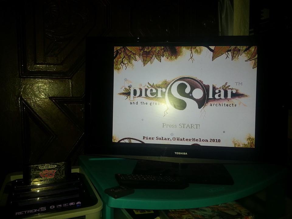

  10. Cryog
    Cryog Member
    Dec 12, 2010
    The last firmware update is the Retron v2.0 BETA 6 (2014-09-18).
    Pier Solar rom working on the RetroN5 !!! The original cartridge don't work.
  11. Eke
    Eke Spirited Member
    Apr 6, 2010
    117
    This is just another evidence they are using existing emulator code (not many emulators support Pier Solar so at this point it's either GenesisPlus GX, Picodrive or a mix of the two). Either, why would have they bothered implementing support for Pier Solar ROM without even being able to dump the ROM from cartridge ?
    Since you seem to be able to abuse their IPS patching feature to run different ROMS, I would be curious to see what results you got with the following Test ROM. Could you do that ?

    Pier Solar is a Genesis rom.
