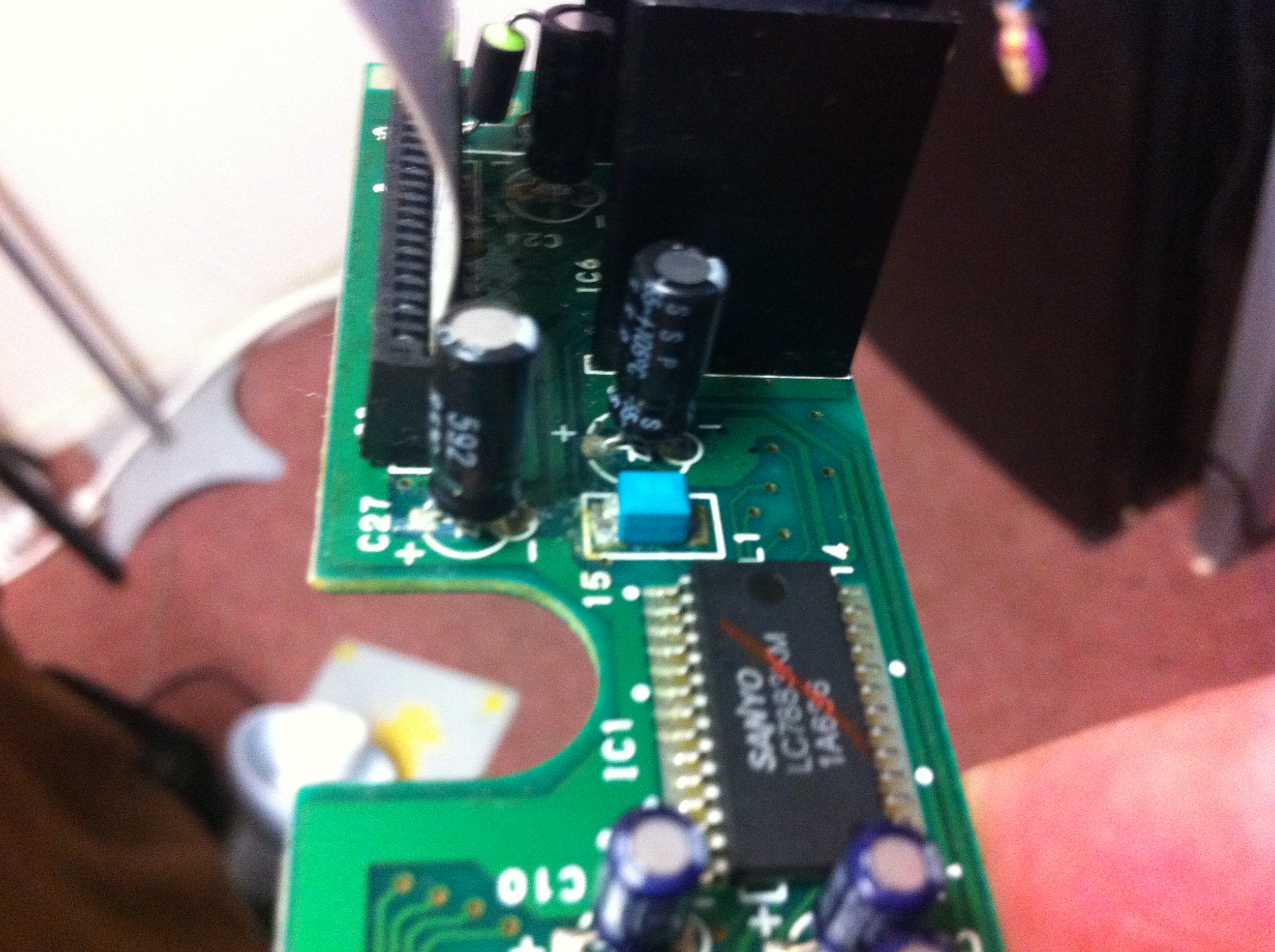

    Okay, the Mega CD arrived today! The AC adaptor hasn't arrived yet, but I thought I'd get it all pulled apart as part of the cleaning process I put all my uses consoles though. As I'm giving the whole thing a good look over, I notice some of the components look odd. Here's a photo:
    It might be a little hard to see, by the solder points on a few of the components near the heatsink, like that aqua colored thing have a little bit of a crust on them. I don't think the capacitors have exploded because, well, they look pretty unexploded from where I'm standing. Should I be worried?

    Not very useful as it's out of focus.
    Make sure you look all the capacitors terminals and if they look like they oxidized, the capacitor leaked. The solder should have a metallic look, not a opaque look.
    Also pay a special attention to the SMD capacitors on the digital board not only they cause disc read errors, they also corrode the traces that might knock the digital board out from working.
    The ones on the analog board at a worst case scenario will leave you with a hum noise or no audio at all.

    Sorry, I wasn't able to focus the camera any better than that :( I didn't spot anything similar to this on the "digital board" (the square board that the Mega Drive itself slots into right?), though when I took a look at the underside of the board in the photo, there's more of that "crust" on the underside of a component. Should I be assuming this "crust" is the result of a leaked capacitor? Will it need to be replaced? And if so, were would I find replacements? Aside from all this, there doesn't seem to be anything else wrong with the console, the tray assembly feels good and solid. The true test will be to see how it behaves once it's AC adaptor arrives!

    The crust is soldering flux residue from the factory.
    Leave it alone as it does even protect the board from oxidization.
    The material that leaks from the capacitor becomes basic (or acidic depending on the chemicals on the capacitor) when it reacts with the oxygen from the air and cause board damage which is quite visible.
    If you don't see any green/brown spots by the capacitor terminals you can assume they did not leak yet.

    Is it normal that this flux residue is only on a few components? I'm not seeing any damage to the silicon board itself, and this crust only seems to cover the solder points, so it may be just that. Well anyway, there's not much I can know at this stage without the AC adaptor :p It should hopefully be arriving soon, I'll let you guys know how everything goes down!
