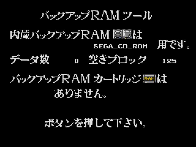

    but look at the attached image it would be nice to have this in english.
    it would be great to replace the japan writing with english.
    i dont know if the text on the startup screen ( where it says "NO DISC" on a us/eu mcd) is a picture or a font.
    if its only a picture maybe we can replace it with the us/eu one so we would have a perfect jap bios with english text.

    All the big text in japanese are compressed tiles, not fonts. Even on the english version they use tiles so you won't find any text inside the BIOS.
    Also translating that is a bit beyond my knowledge, sadly ... :shrug:
