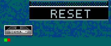

    Out of curiosity, does this appear on the real Wondermega when you open the lid ? (Attached picture)
    It doesn't show on the real hardware when I eject but does show on KEGA Fusion.

    No, that picture is not displayed on the real hw, i think that the emulator recognized the special bios call involved with opening the automated lid or detects the bios accessing a specific memory region where access to this hw is mapped (like TmEE suggested).

    Yah I suspected it would be from the emulator. Thanks for confirmation.
