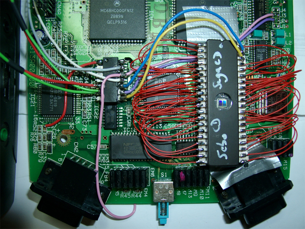

    There are several different capacitors on the board but I suppose most of them are 10uf 16v. They all have their values written on them. :thumbsup:
    Now, as per the bios, if you write just 128KB of a 512KB chip, you're supposed to connect the two extra address lines to the ground (GND) or otherwise the system will glitch badly. Even if you're using the chip with 4 copies of the bios burnt in it, you SHOULD connect the two excess address pins either to GND or VCC. :shrug:

    How do i know witch two excess address pins i should connect?
    Is it to ground or VCC?

    A17 and A16 are your pins. VCC=1 (+5v) VSS=0 (GND)

    I replaced all the capacitor on the motherboard and grounded pins 39 (A17) and 38 (A16).
    Put it back together and BAM first try! So if you have problems with your region free bios just ground pin 38 and 39. It is also recommended to replace the caps. I am crying blood right now! I am so happy that it works again! I wanna thank DarthCloud and Eddyiori for helping me! Sorry for trashing the tread
    But my biggest thank you to l_oliveira for saving my Mega CD and making the region free bios! I love it! I kneel before you.

    What type of EPROM for replacement ?

    Yes. ROM file should be byte swapped (68000 is big endian). :thumbsup:

    Is there a similar chip that can replace the:

    MX27C1024 is the right pinout if i remember correctly. but the original chip is a sop40 and has no direct replacement (that I could find anyway)
    MX27C1024 and wiring it up would be your best choice as its right pinout - unless someone else knows another chip
