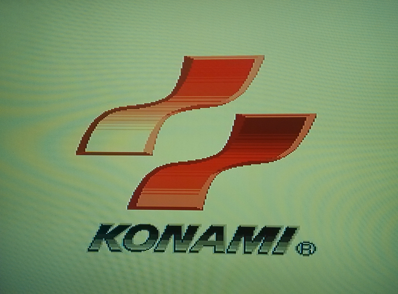

    Thanks for all the help, guys. I was wondering, what amp are you guys using in the Genesis to go right from RGB to the cable? Meaning, not passing through an encoder? I tried this with the SNES to try and remove the thick vertical line issue, and I get this as a picture:
    Again keep in mind I completely desoldered the stock encoder so I can see if the encoder is the culprit. So I guess the encoder actually has an amp in it! However, I am not sure why the red in my pic is so streaky? Why would this happen? It's going right to an XRGB Mini. Sorry if this is a bit off topic; I just figured I could use whatever amp was used in post #72.

    Master System and Genesis hardware architecture is too different from SNES for that.
    Entirely different looking vertical bars with unrelated causes.

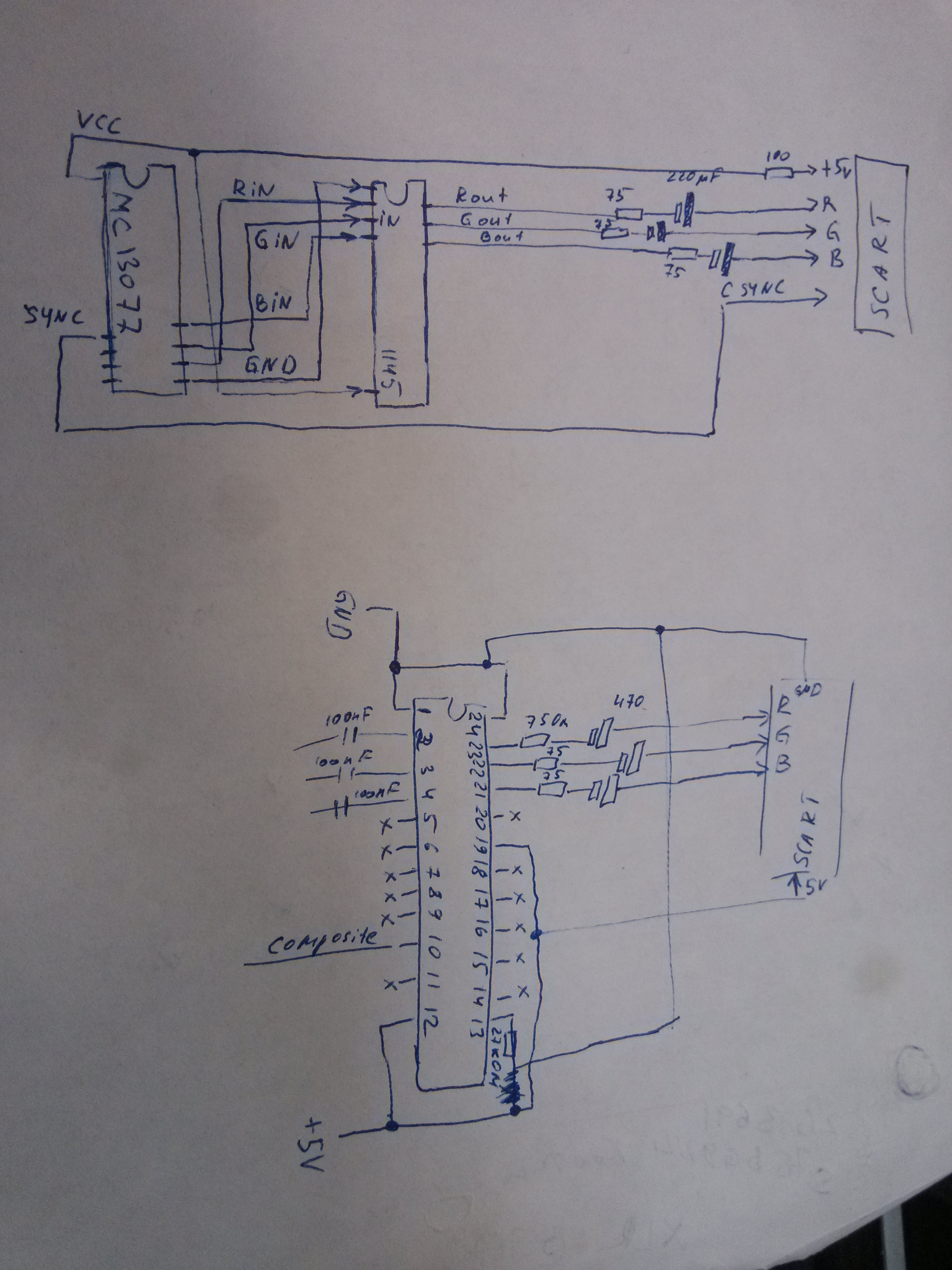

    good day. i have a sega with mc13077 Ic, as i see it have RGB inputs, but not outputs, i want to use cxa1145 as rgb encoder, can anyone help me?
    i drawing a picture how its could be, but i think there was i mistake.
    p.s. sorry for my bad english.

    SONY video encoders are quite "anal" about having the sync input at 2v level. I don't see why that would not work as long you keep the 2v thing in mind.
    Maybe if you copy the original circuit from a legit Mega Drive console it would work for you. (just the sync part, the stuff you already drawn looks fine, mostly but the sync part is wrong).
    Edit: just making sure you understand, the CXA1145 REQUIRES SYNC for the proper operation of the clamping circuit on the RGB amplifier. No sync, no output.

    i get the sync in from 13077 and connect it to 1145, and from 1145 sync out connect to composite in the scart cable, but the image was a dark red .

    That's because you have a clone megadrive and it's circuit is made for the MC13077. Sync signal voltage is WRONG for the CXA chip.

    Anar Member

    Copy the electronics schematic of the real Mega Drive maybe ... That's what I said the first time.
