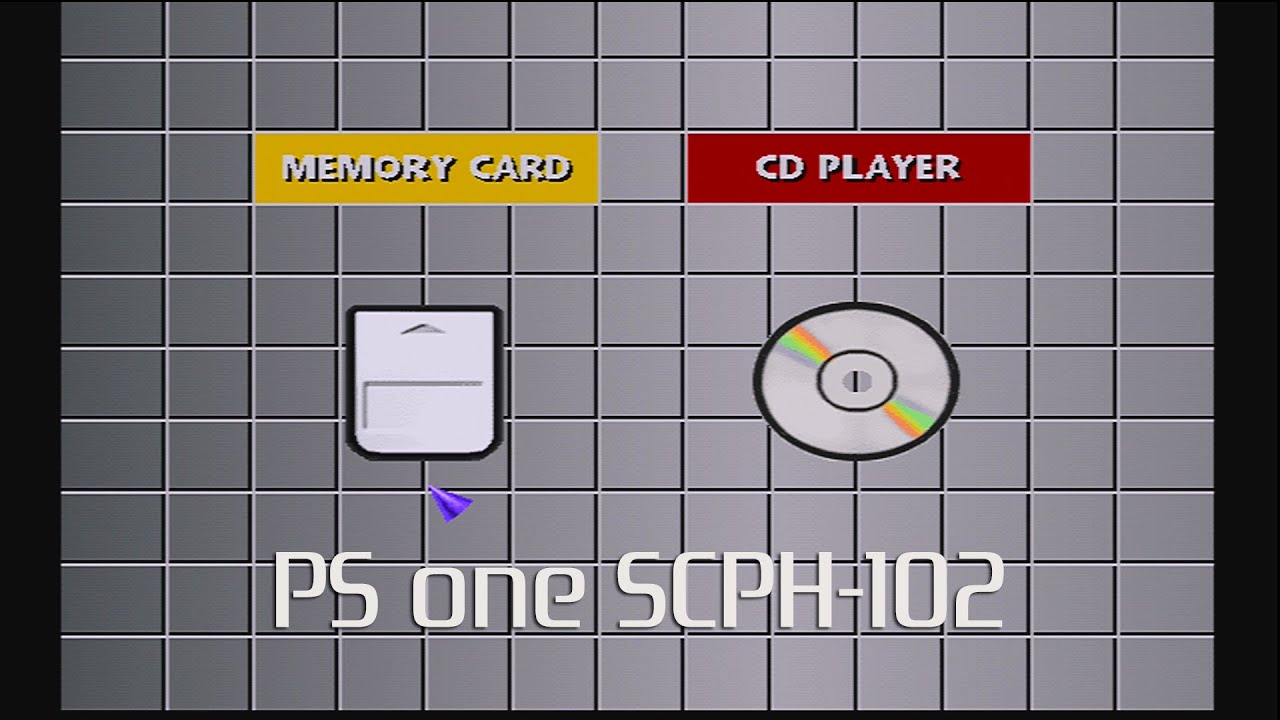

    slayer try the boot method i mentioned. Turn the PS1 on and let it go to the CD Player and Memory Card menu , then pop in a backup and close the lid. I get the best success with my PS1's with this method i also use a MM3. Btw POT tweaking is bad and will shorten the life of the Laser.
    CD Player Screen and Memory Card menu below , a couple of different ones
